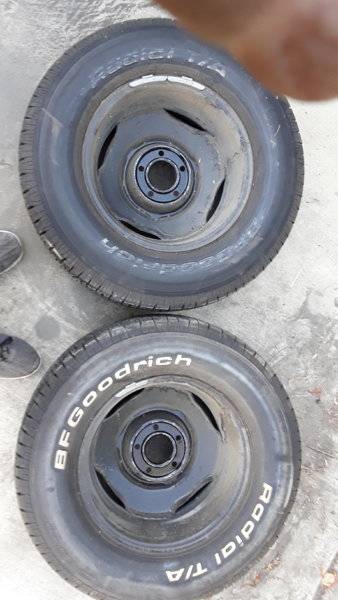

Just curious about front backspacing on a 66 satelite.wanted 6 inch fronts im thinking 3.5 would be good but wanted to see if anyone is running this....
I could be more helpful if i was home with my records, but....i ran a set of factory 15x6 steelies with (i think)3 3/4 bs, with 235-70x15 on the front of a 69 runner, and a 62 savoy. I was surprised when i changed wheel/tire combo , i found that one side was rubbing, i think on the header tube in the fenderwell. I think a 15x6 with 3.5 should work.
Edit: i think it rubbed the header tube, but only at full lock left turn.
Ran 15"x 7" wheels 4" BS no problem. H60, about 8" tread width.
