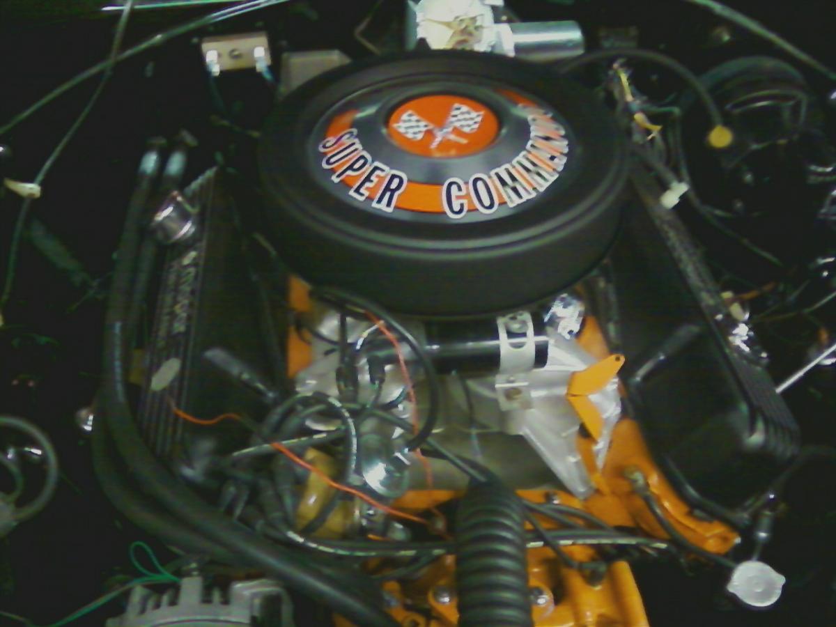

I have a 440 in my 66 belvedere with a edelbrock RPM intake (which is taller then the performer) with a stock breather which doesn't have a drop base and it doesn't rub the hood. I did install a shorter filter.
