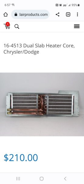

66 Satellite heater core?
No. Not even close

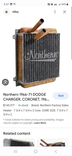

Non air cars use a single core
If your A/C box has a leak inside it may not be the heater core leaking. Take it apart and inspect.
