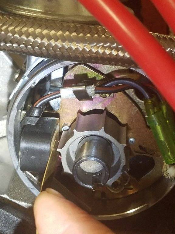

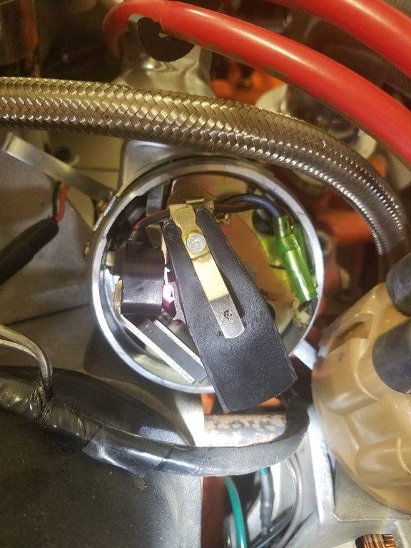

Overhead pic of distributor with cap removed for clarity:
My fat finger holding the feeler gauge in the gap..Note: the point on the distributor collar needs to be directly lined up with the point on the pickup for the air gap measurement( which is hidden by the feeler gauge but you will see it) so the proper way to check this is to pop the distributor out of the engine so you can rotate it and make sure your feeler gauge fits snugly at the moment each of the eight points rotate past the pickup point
....I apologize if you already know how to do all this stuff just trying to be as clear and helpful as possible:thumbsup:
( if you do this make absolutely sure your distributor ends up back in the motor in the exact same position as it was before you took it out or you'll have more problems and be cussin' ol beanhead...!)
Again sorry if you know that stuff!
