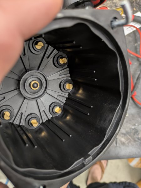

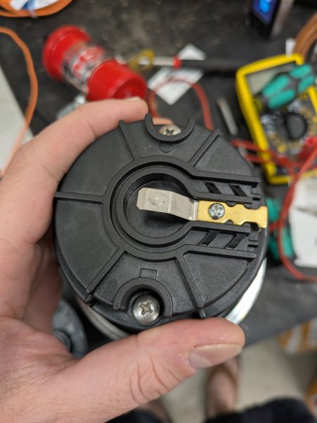

Can you post some pictures of the rotor / cap? Are you sure the metal tab of rotor is making contact with center/ coil contact of the distributor
Even bent the tab a bit up to make sure its contacting

What distributor is that?
Looks like a GM-hermaphrodite distributor adapted to fit a Mopar application. Are you sure the Pertronics module is functioning? It functions like a Hall effect magnetic switch, switching coil primary current......

You have secondary voltage at the coil wire, so to me that verifies the coil, coil wire, distributor trigger switch, wiring, etc. The ONLY thing I can point at is the cap center carbon button. I know you tried 3 caps, but if voltage goes to the cap, but does not come out, my money is the distributor cap button, and before you poo-poo that, I actually had a Prestolite cap with a removable carbon button did that exact thing. I ordered a cap from Year One, and wrapped the button in tin foil so I could drive the car until the new cap arrived.

- how can i proof the rotor is getting the spark?
- how can i proof its getting to the dist cap / spark plug wires

Pull the cap , hook up the coil wire to the cap. Now find something to touch the center pin and try and make it jump to one of the plug contacts . Becareful !
