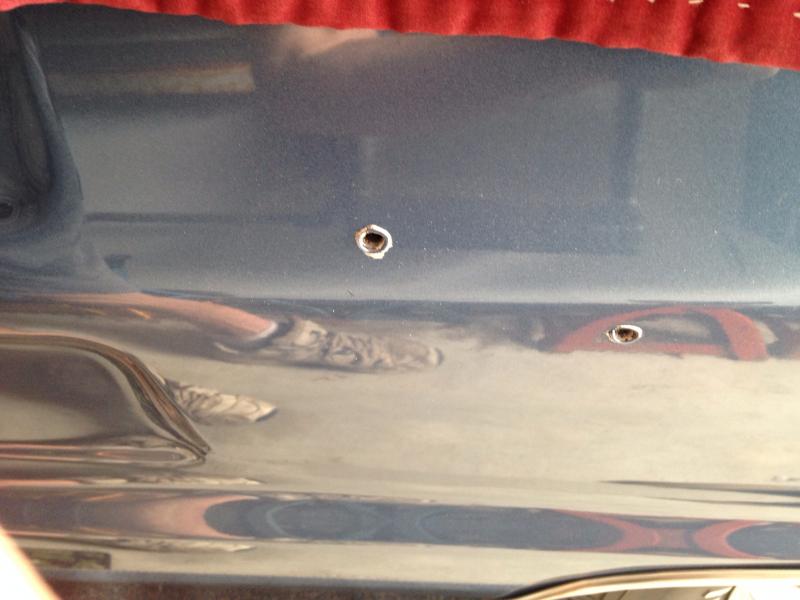

Is there a way to access the back side of the front fenders without removing them. I want to install hemi badges and once I drill the holes I'll need to bolt them down. Any tricks?

You can remove rear splash shields...
You can also use I think they call them blind nuts that's what I did so I could take the emblems off and on with ease clean behind them. That might not be the right name but they push in to the fender and then the pegs from the emblem slide into them. But they look like this image.jpg
AutoZone carries them or any auto parts store there in the racks with the bolts and nuts and clips that they sell
Yes The pegs from the emblem slide right in the holes. I take them off with my fingers and they hold strong enough that the emblem will not fall off. I pull them off wax underneath them clean up the emblems and put them right back on
Let us know how you make out they come in all different sizes
Ended up taking the splash shields off and using the supplied nuts. Wasn't able to find blind nuts in the size I wanted.
