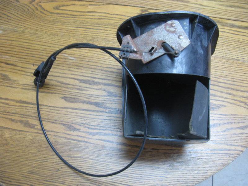

Most cars in Hawaii and south of the border had them. All the S/S cars did, too. Special right vent-box, and plates to block the defroster slots were also part of the pkg. Real dash-delete plates are expensive.

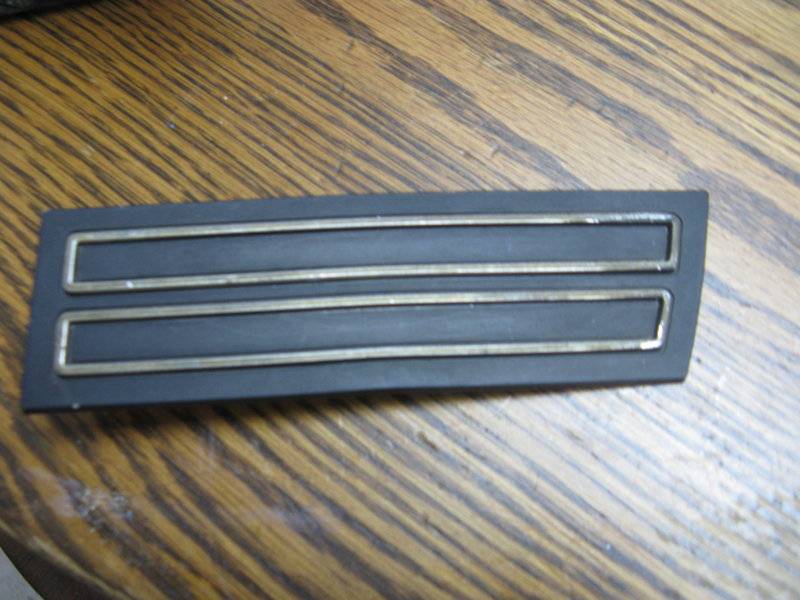

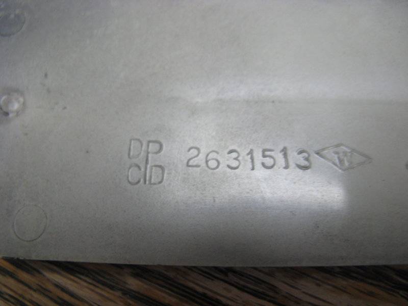

I have the correct special RH vent box and cable. I also think I have the dash bezel is this the right one?
