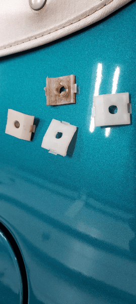

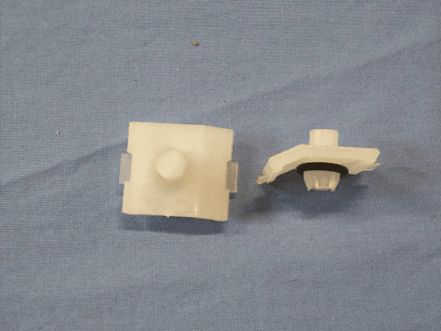

The white plastic clips are the ones that are used in most of the holes on the body for the upper body side molding. Not pictured are the short little plastic rods that push in from the outside to spread the 4 tangs apart on the inside of the sheet metal. I didn't find these on a quick search of RT Specialties website or Layson's website. I was thinking it was one of them, but maybe someone else could tell you who has them. Or a phone call to both companies might help to find them. Pretty sure I found mine at a vendor at Chrysler Carlisle.
The four metal clips in the other photo are generic fasteners available from any place that sells body fasteners. They are similar to the two on each front fender. But, the factory ones have the stud off center to the top of the trim (to fit holes in the fender that are higher up than all the other fastener holes). To make these pieces work, you'll need to file down or cut off the end of the clip farthest from the spring.
The square metal clip with the broken off stud is the piece used for the trim at the leading and trailing ends of each door. The same studded clips shown for the front fenders can be used for the ends of each door without modification (they can also be used, unmodified, anywhere else along the length of the trim that you can reach to get a nut on the inside).
