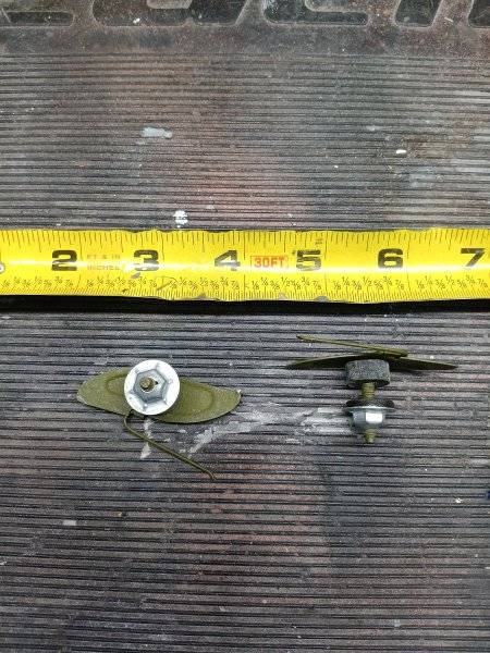

Hi all I have a 69 satellite
I noticed some of my trim clips are failing it’s the lower door and rear quarter panel trim
Who does replacements
I am at a loss on what to look for any help

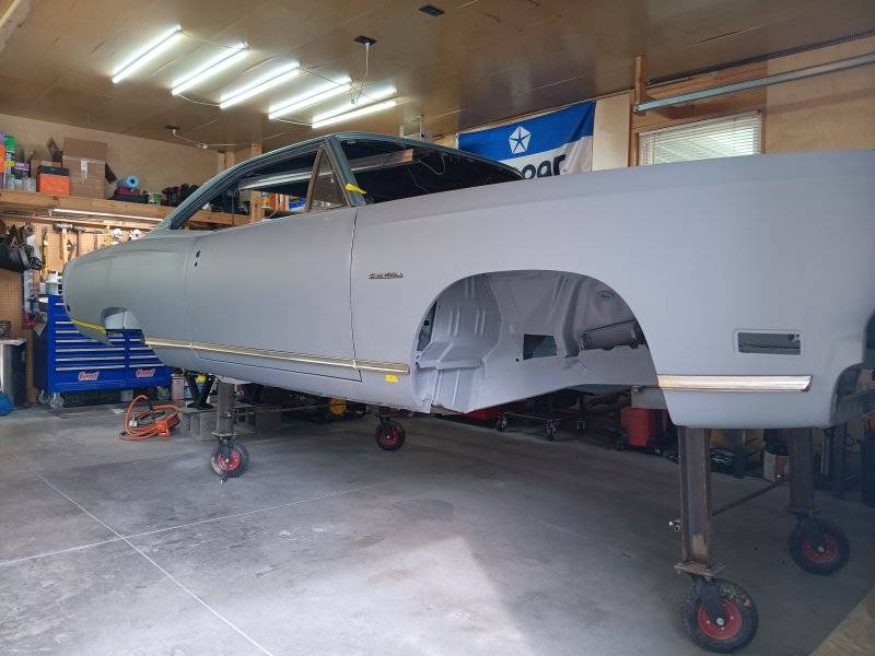

Ended up getting universal style for my trim off ebay ( altha fastener), didnt have any original that were not broken.
The rear qtr behind the wheel well is the worst. not enough room to fit between the qtr and inner trunk drop off. Had to drill all the way through and put body plugs in the drop offs.
