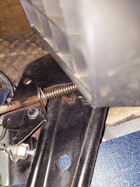

There is a plastic bushing that is supposed to keep release spring in place (they get brittle and break) This what I did ,split a washer bend it open ,put around release shaft bend it back flat, done deal. See crude pic:poke:

I realize this is an older thread. But I just fixed this issue - or a similar one a few months ago. (I've been away for while) My e-brake pedal wasn't ratcheting or staying in place. Turns out the spring that applies tension to the ratcheting mechanism was missing. It's impossible to see this spring without removing the e-brake mechanism. The release handle return spring also needed the bushing Tinker67 refers to in post #5. In addition to that, the cable adjustment nut was also seized, requiring a new cable and removal of the pedal mechanism.
I ended up restoring the pedal assembly and with the new cable, properly adjusted, the e-brake works fine now. I located a bushing at my local hardware store and found a suitable spring at the local auto parts store. I altered the spring ends to match the shape needed. Wishing I had taken some photos now.
