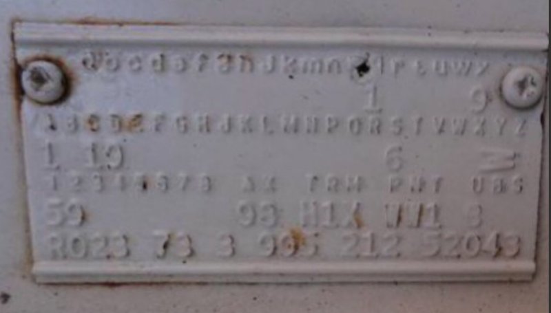

I forgot to add that my fender tag has 995 for tires. According to my sales code reference book, 99 is for "Special Order" and the number "5" is the number of tires.
The 995 means special order tires in quantity 5. So it had a spare. Did it have a jack?

Here is a tag from the web
