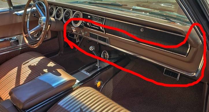

My 67 Charger's dash is missing the part circled in red in this pic. Does anyone know the P/N or proper name for it? I'm hoping someone offers a repro at least.
Not my car. If I can find one I expect I'll have to manage the color.
Thanks!

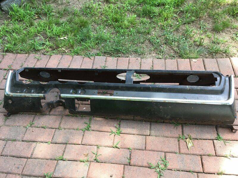

Well the tan part is connected to the entire dash frame. Like it’s one big stamping, it doesn’t come apart without a saw.
1966 and 1967 dash frames are different in the steering column area and don’t interchange.
Interesting, probably why I can't find anything.
Here you can see it out of its natural habitat. All one piece the chrome is the only thing that comes off besides the dash pad and the glove box door and the cluster stuff.
Noted! Thank you sir
What are differences in column areas if you don’t mind me asking? Have a 67 and it seems like something is missing

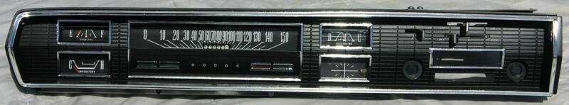

That chrome is made into the cluster and glovebox cover. Its kind of a foil on the plastic.
I know this isn't the charger cluster. But you can see its like a chrome overlay of a sort. Not sure how they chromed plastic back then. I tried with some Chrome pens to fix it. Didn't turn out bad but ended up selling the project. This picture is not my rechrome.. Just one I found on the web.
Here is the video I did. I was pretty much just testing the Molito Chrome pens. They work pretty well I just have a lack of precision. But it wasn't too bad for a first attempt.
