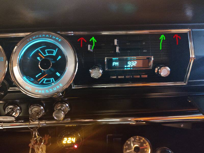

Ok, I just have to find the screws.
Let Me help
It will be either the red ones or the green ones
I dont recall which is which but it will be obvious when you look at it
