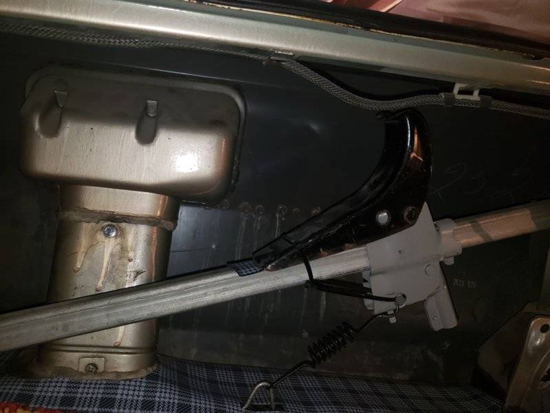

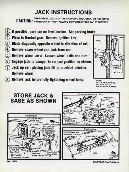

Welcome. Use the sedan picture as reference.

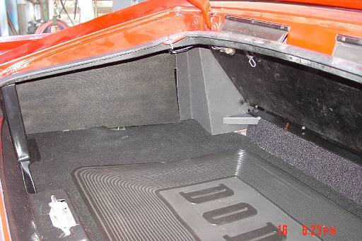

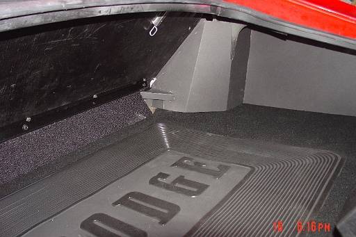

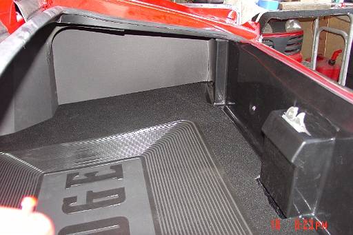

Yep, that is pretty much it except for the mat in the trunk (should be carpet). But there should be a panel on the left/driver side. Behind the panel is where the jack is hidden.

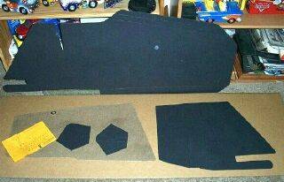

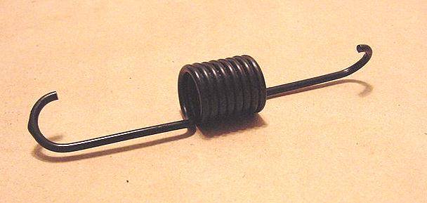

Here is a pic of the spring and trunk panel kit.

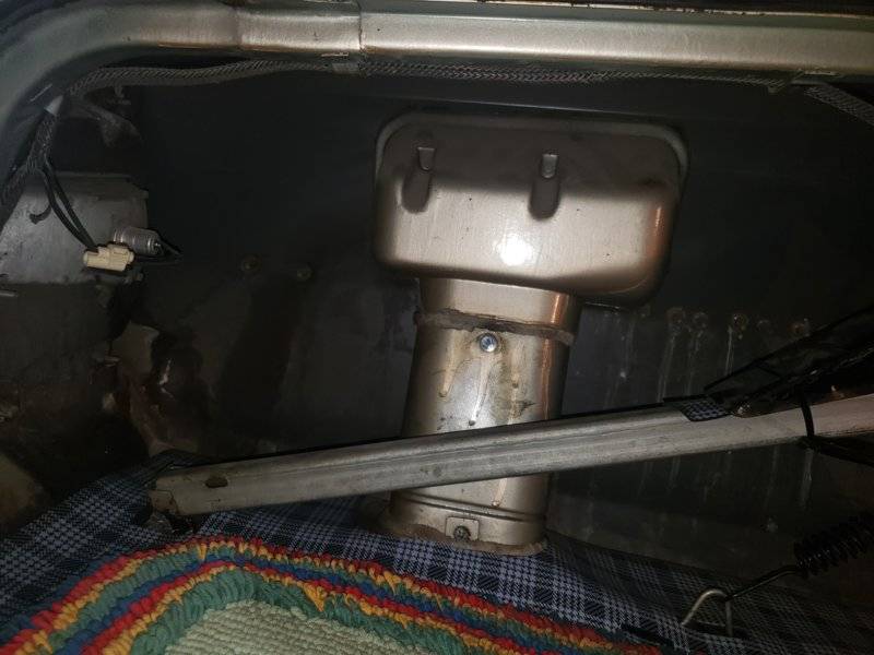

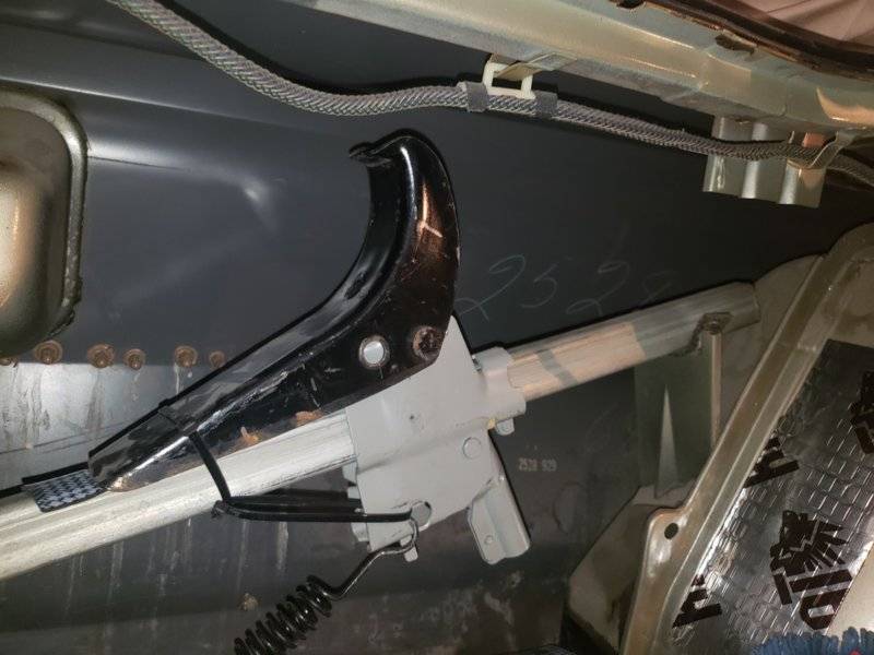

I have no clue on the Charger, mine is a '67 Coronet. But completely original in the trunk as I inherited it from my Great grandmother. The Coronet 440 did not have a panel or carpet. Just a houndstooth plastic/rubberized mat. The Charger looks nice.
Oh, apologies ... I thought it was a Charger. Coronet goes in the same place, no cover and mat is correct.
