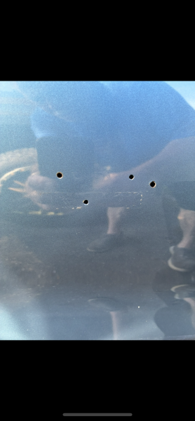

I have a 67 R/T Coronet can someone tell me what front fender emblem goes here Thanks

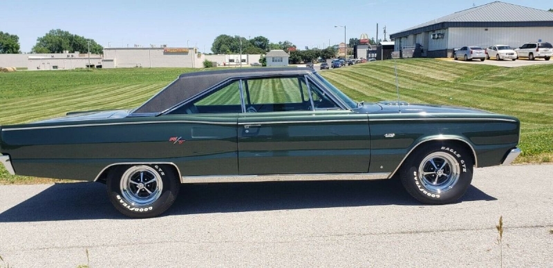

That's not a very good photo to show us the location on the fender. The only fender emblem on a 67 r/t (besides the chrysler logo) would be 426 Hemi. Is yours a hemi car?
Sorry about that I wish my car was a hemi but no it’s not a hemi the location in my picture is the same as your picture my car has a 440

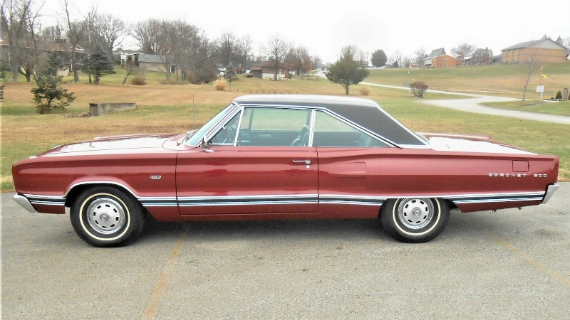

Hmmm, as far as i know the only 67 r/t's with emblems in that location are hemi cars. Some 67 Coronet 500's came with engine size badges in that location. Could be someone swapped in a different fender? Or i've seen where people just want to add that badge even if it doesn't belong.
Thought that too but every 383 four barrel emblem I found only has 3 pins to attach it my fenders have 4 holes to attach a emblem
A 2 barrel v8 car would have "V8".
The V8 emblem only has 2 pins to attach it to the render I have 4 holes
Could be V-8 holes and added 383 Four Barrel holes?
