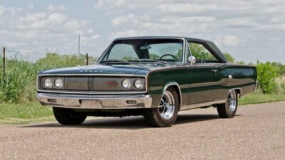

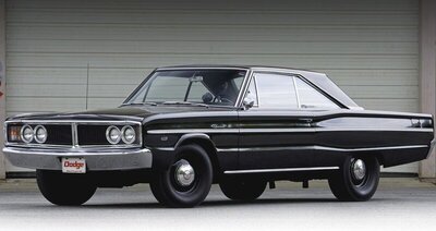

I am looking at purchasing a 66 coronet, but I love the look of the R/T front grill from the 67. I prefer the taillights on the 66 over the 67. This is why I figured it was easier to swap grills than cutting out the taillights. Is it an easy swap or is there lots of cutting end fabrication involved?

Nothing interchanges really, buckets are different, fenders ECT.
There is a bit of work involved. Nothing too terribly hard. I was going to do this myself. I'm sure glad I didn't now......although I do have a 67 front bumper because that is all I have.
The headlights are more inboard on a 66 than a 67. I put a 66 fender on my 67, and had to fabricate a headlight mounting bracket. The park/turn lights are of course in a different location.
Yes. It can be done. The head light buckets are different and mounted differently although the structure to mount them up is there on either. The space across the front is identical. The trim is the same on the outer edges. The crossbars under and behind the surrounds are the same. The biggest hurdle is the fenders inner nose structure. To make it easier just get a pair of 67 fenders and bolt them up. Then install the grill. You will need a 67 bumper for the turn signals as the 67 grill does not incorporate them.. It's the same when you install a 66 Charger grill into a 67 Coronet. The turn signals are in the grill and you then need a 66 Charger bumper. Good luck finding an RT center grille section.
The trim around the outer edges is not the same. While the fenders are the same, the trim surround has a different shape, or profile, between the two years. (We have one of each here.)
