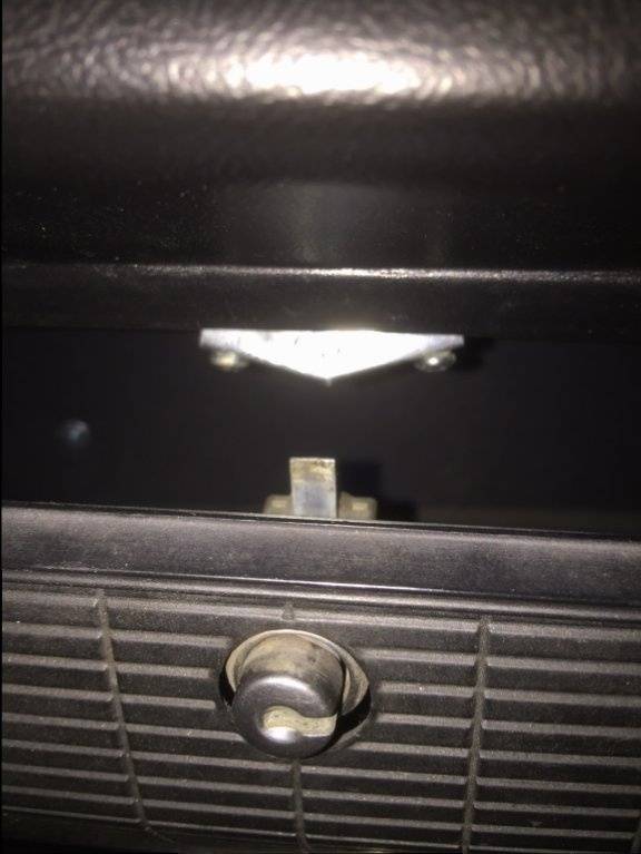

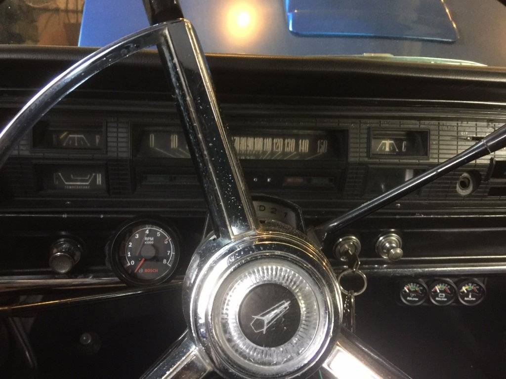

I'll have to get a pic of the fan, but here is the dash, followed by a pic of my ghetto glovebox fix that works surprisingly well. It is the receiving end of a drywall anchor that I drilled 2 holes in to align with the stock holes for the glovebox latch, then just used slightly longer screws to secure it.

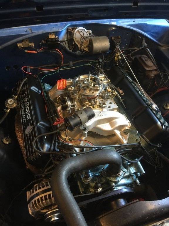

Today was educational. I have been away from the car for a while getting things off the honeydo list. Finally had some time today and went to put the new mopar valve covers on when I made the discovery that I can't reuse the stock breather cap and PCV. So now waiting on yet more parts.

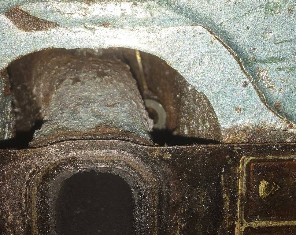

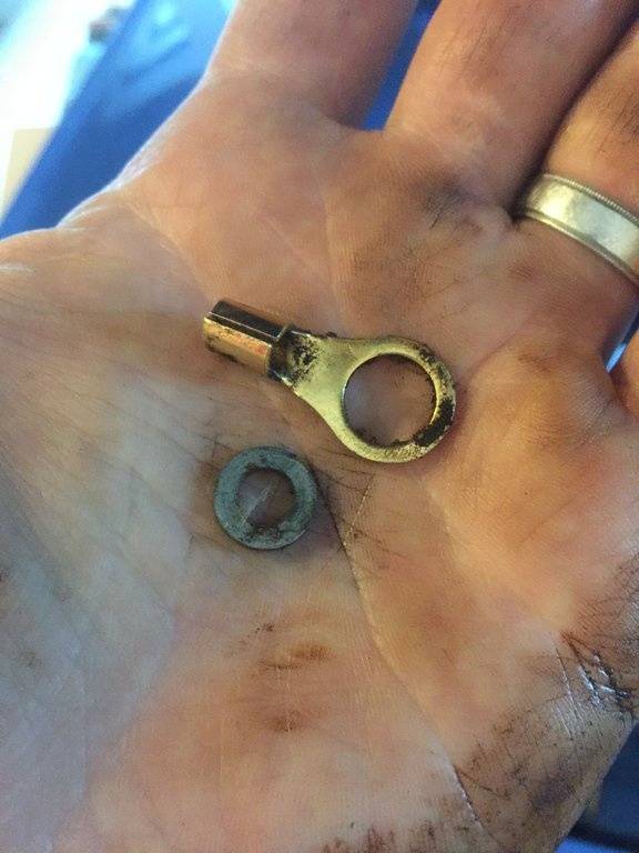

Decided to move on. Opened my carb and intake boxes and discovered they don't include manifold gaskets. Sigh. Add that to the order. But went ahead and pulled the old stuff off while I have the time. Found a couple of interesting things. 1) no gasket was used on either side of the valley pan, which probably explains that particular oil leak. And 2) someone dropped a washer and electrical connector and decided it wasn't worth fishing them out of the head crevice. Not too comforting to think what else they didn't bother with.
Sticking with stock. I can't imagine there would be any performance improvement with anything else. I'm keeping my fingers crossed for the correct 440 Magnum air cleaner cover to find its way into my hands on fathers' day. :)
The lockwasher&eyelet would've helped the heat transfer,lol!
Finally tuned the carb and took it for a quick drive today. It could spin the tires a bit before on takeoff, but now it downright lights them up. I had to back off the throttle to gain traction.
It did, however, get hot again. The thermal switch is not doing its job. So I'm just going to run to a toggle switch in the cockpit.

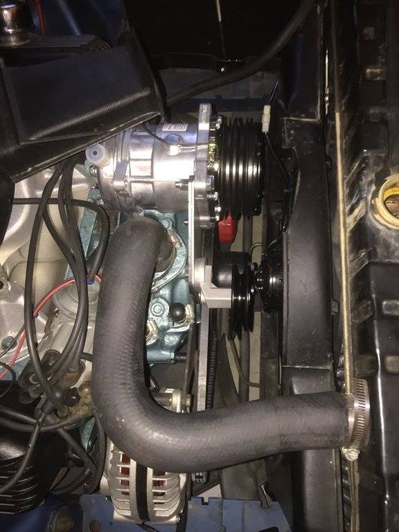

Moved on to the AC install today, too. It is beating me up a bit but I'm slowly winning.
Ok, have you checked the thermostat, timing, etc? You will be generating more heat with the a/c.
