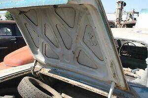

Recently picked up a 66 Coronet 500. It was missing the trunk lid, hood, doors, tail light housings, and pretty much everything. Basically a shell with all the exterior trim and glass. I happen to have spare 67 tail light housings, 67 trunk lid, 67 hood, 67 fenders, 67 grills, wirining, dash, etc. Just wondering if this stuff will bolt on without issue. Hoping to make a 66/67 hybrid since i have a lot of spare 67 parts.

If it's all used together, then yes.
Your car will look like a 67.
I agree a 66 should be kept looking like a 66 though.

I've had several 66's with 67 hood lip trim because for some reason the 67 part is WAY easier to find used in good condition than the 66.

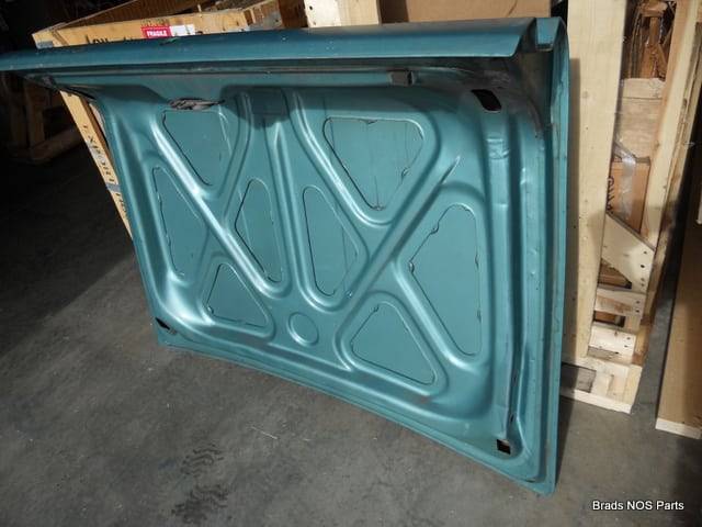

BTW the hoods are identical but the deck lid body lines are different.

back up lights are on the trunk lid on a 66
they are in the bumper on a 67
