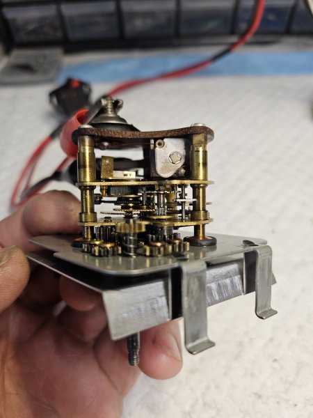

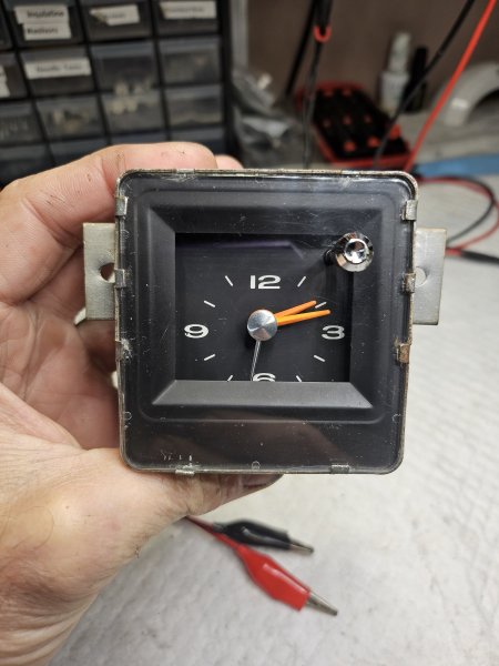

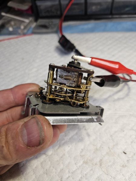

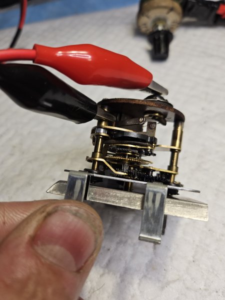

Just completed the restoration
Looks great.... I have messed with a couple of these clocks and found that they just dried out and stop working ,,, most just needed to be oiled correctly and bench run.
Nice work. I went through the same on my 66 Satellites clock a few years ago. What it needed most was a light filing of the points but I also cleaned and oiled it lightly with gun oil. I use a battery cut off when my car is parked so it never has the right time, but every time I take it out the hands are moving.
I removed my clock through the glovebox. When I disassembled it I saw that the contact points were stuck together. I separated them, filed them with an emery board, lightly oiled the moving parts and reassembled everything. 12 hours later it still works. Time will tell!:p
