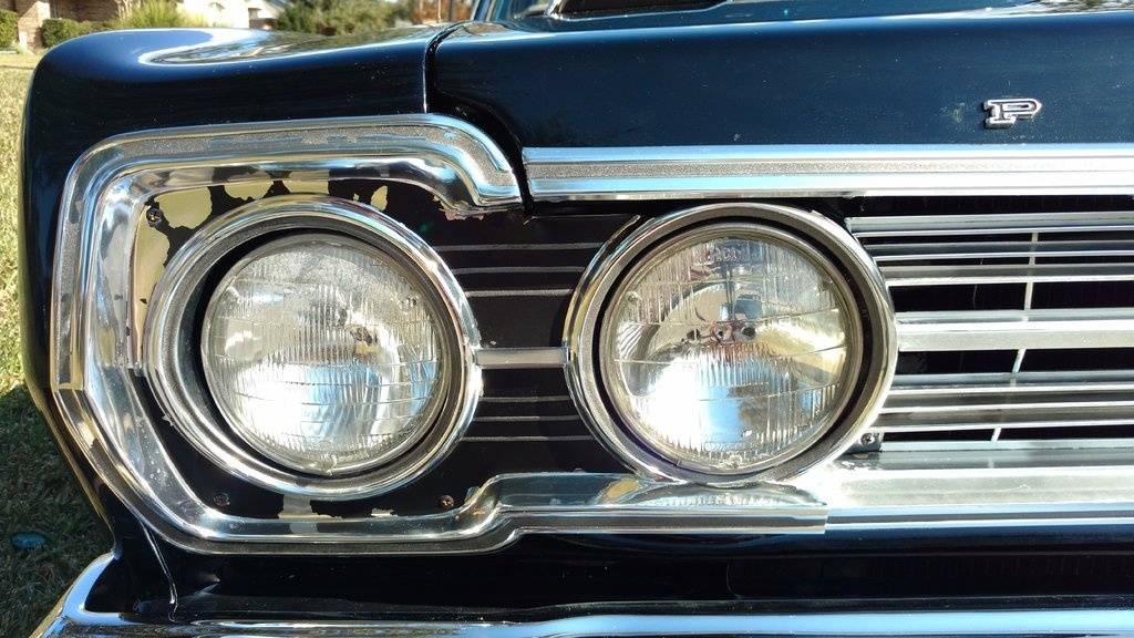

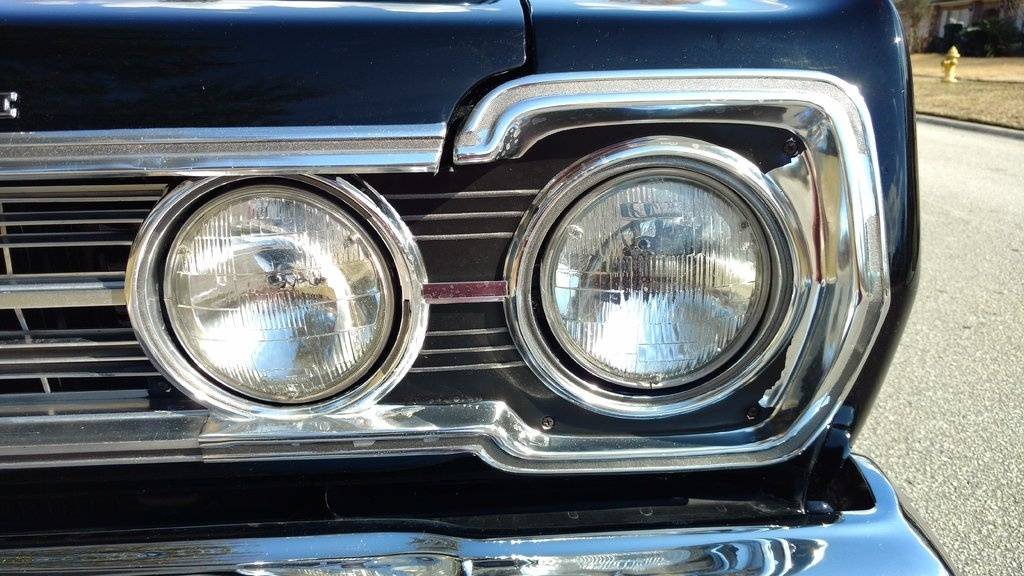

I sent mine to King of Trim in CA and they charged me around $500. They looked great when I got them back, but within a couple of months of putting them back on the car, the black paint and argent paint both started peeling off. Car is a garage queen and never out in the elements (see pictures). I called King of Trim and they said to return them and they had a bad batch of primer. They look like they may not have been primed at all. I stripped and repainted them myself rather than pay shipping again and have them gone another month. I used an etching primer. They have held up well since. The hood lip and grill argent I originally painted myself using an etching primer have held up well also. These are for a 67 GTX and masking and painting the black and argent combination separately was kind of a PITA. I think I restripped and repainted the headlight bezels three times before I was happy with the outcome.
