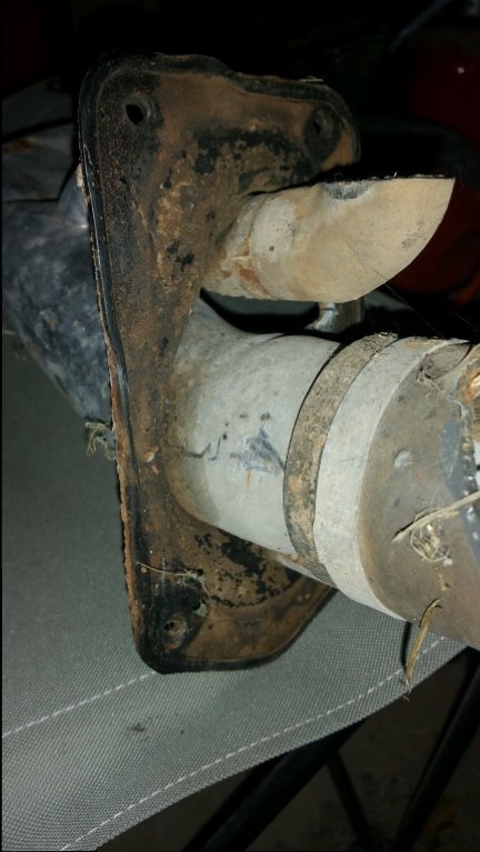

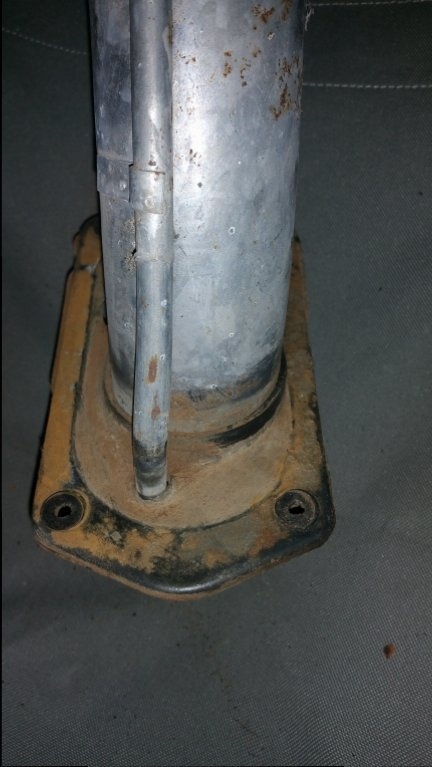

So I installed my OEM gas tank and fuel hose connections to the filler neck, 67 GTX. The previous setup was fuel cell so the pass through on the drivers side of the trunk pan had a steel plate screwed in as a blank. Does anyone have pictures of the factory setup and how it passes through the trunk floor, was there a rubber boot there or something?

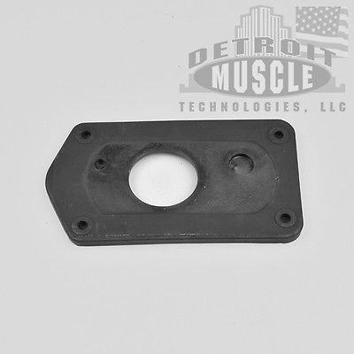

I have a picture of one in the for sale section, I will look and see what page its on.
I found it on page 15 of the exterior parts for sale. It doesn't show a direct picture of the rubber seal but it is on the bottom of the plate that mounts to the floor.
It looks like the bottom plate is plastic with some sort of rubber on it. Is this the part you mean?
