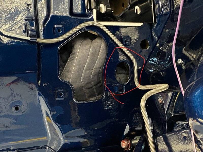

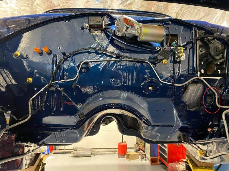

The lines from Inline tube for this car really fit pretty poorly. In the pictures where I circled I could have just as easily massaged the line to fit on the other side of that oval opening were the link from the clutch pedal passes through the firewall. I did it the way pictured. I don’t want to find out after the Hemi is lifted in place that it should have been on the other side because of z bar or link interference. Could members with 4 speed 67 GTX cars take a peek at there routing and let me know?

I realize they offer a straight line across the firewall and this one with the 4 inch hump in the middle of the firewall. I figured the rest would be similar.

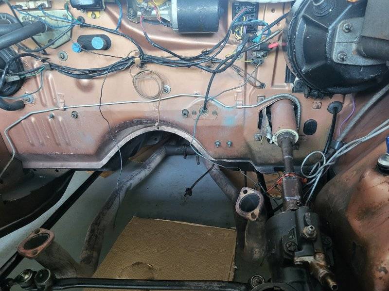

Can't tell you for sure, but this is what the original firewall brake line looks like on my 67 Satellite - not a hemi or 4 speed, but it clears the clutch rod opening and the shape looks different than what you have.
The replacement line on my 67 Belv is different - more like yours, but again not a hemi or 4 speed.
