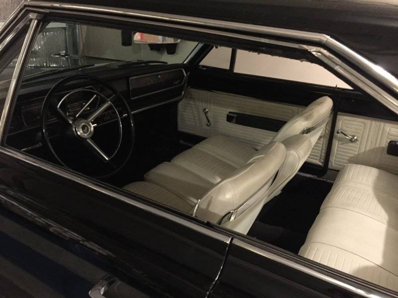

My satellite has a black exterior, and cream/white interior from legendary that is in OK shape but starting to show its age. I cover everything with a sheet on the rare occasions I park outside in the sun, but it is still yellowing with age and seats are starting to wear from my butt scooting across them.
I am in the beginning stages of planning an interior swap. First of all, I do not like the satellite/gtx interior with the western scroll. I much prefer the Belvedere II pattern. I also have the individual front seats with the buddy/seat armrest in the middle; I’m going to swap that out for a split bench. With the amount of nose down rake my car has, I use blocks under the driver seat to lean it back to a comfortable angle, I will be doing this to the whole bench.

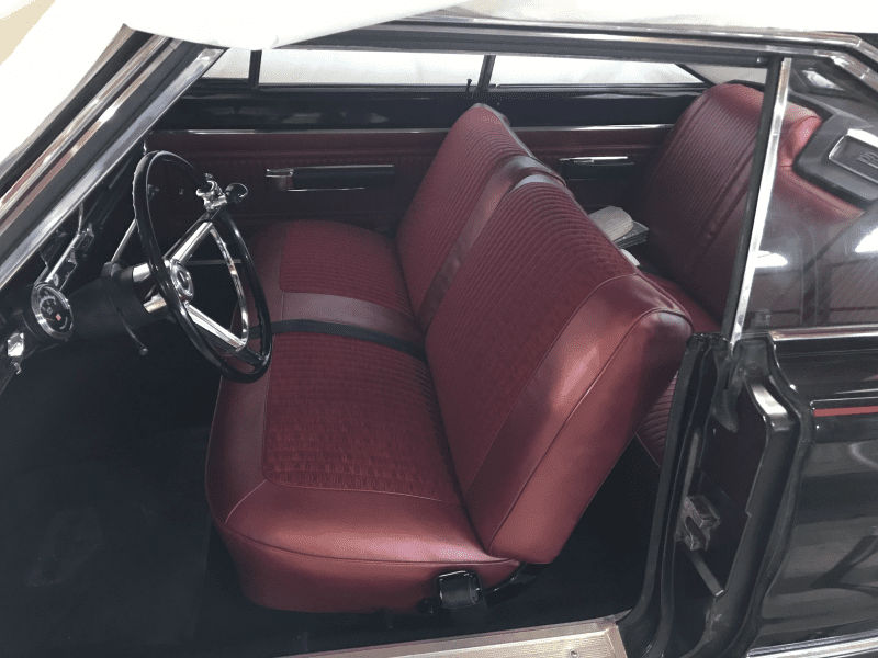

It took a few years, but here is the semi-finished product. In the process of cleaning up and storing the white western scroll interior for sale. Turns out the seats were legendary, circa late 90's, and the door panels were original. All in really nice shape, I just didn't like the white.
-Adapting split bench was easy, but surprisingly the seating position is about 2-3" higher up than the buckets. My head almost touches the headliner now.
-The metal brackets for the buddy seat get in the way. Currently I can't slide the bench until I cut off the front bracket. Rear bracket clears fine.
-the door panels were designed to be used without chrome trim, but with some work I was able to fit them with the top trim. Bottom trim is of course fastened to the original panels with brads.
In summary, if you have a '67 satellite you can swap out the entire interior easily with other B-body parts with the exception of the upper rear seat. With that one you are limited to western scroll or will need to have a custom cover made due to the unique shape of the upper seat.
