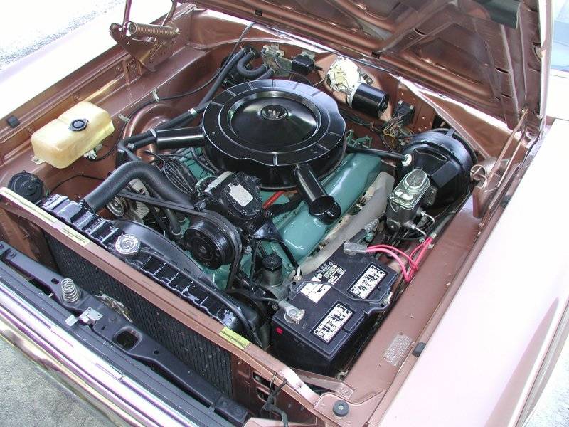

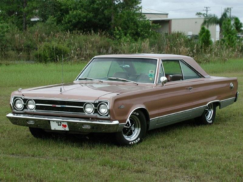

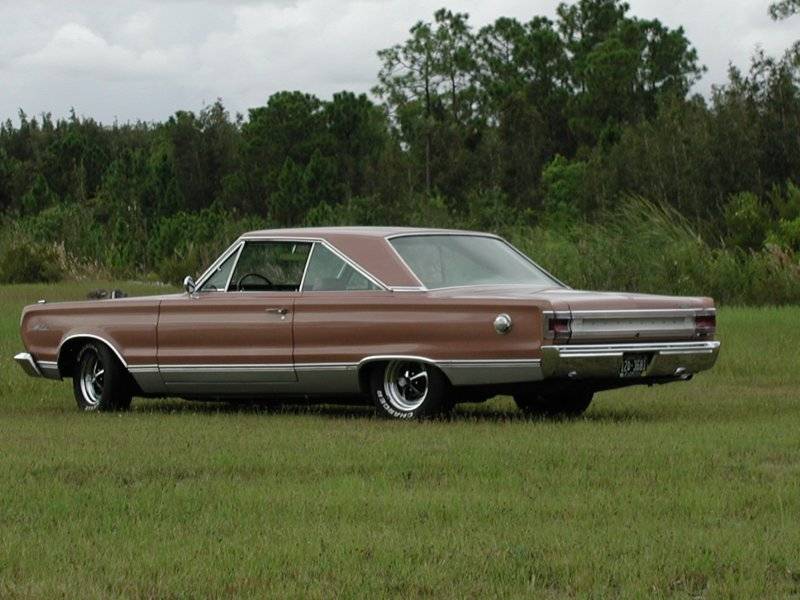

A few pics of my 67 383 4bbl for comparison. Mine is not 100% original anymore, but very close. Most noticeable changes are the GTX gas cap, 68-69 hi-po manifolds and A/C is incomplete though I have all the original parts. ]]
View attachment 1805927View attachment 1805928View attachment 1805930View attachment 1805929

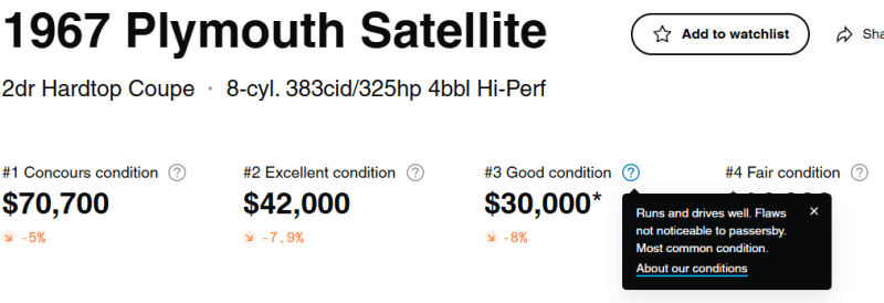

That's interesting. I pulled up Hagerty yesterday and #2 was $40k. I was surprised to see $42k on your screenshot so I pulled it up again just now - $42k. It went up $2k overnight. I have a top dollar in mind that might keep me from making the deal, but it's all subject to inspection. If the overall condition doesn't meet my standards for a driver, I'll just pass. I've seen what appears to be factory undercoating on more than one Satellite. Does yours have that?From Haggerty
The average is $22,450
Bought my 67 Belvedere II 383 4-bbl similar condition, 84k documented mileage, well kept, original inside and out, but with a bit of quarter panel rust $18k flat. At the time this number was average between good and fair. I thought I got a great deal.
