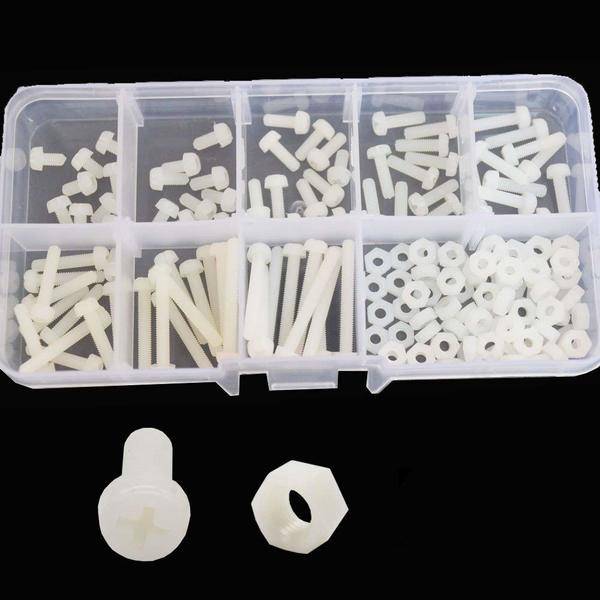

It seems there is a ton of attempted fixes for this problem But why not just drill the hole all the way through the lower shaft and use nylon nuts and bolts to go through the shafts. They would still shear off in the event of a crash. Seems like it would work just as the original was intended.
