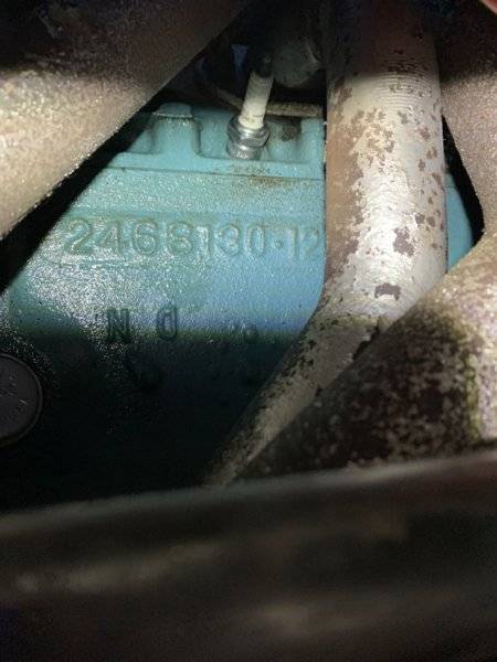

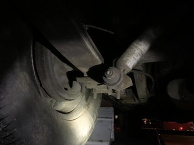

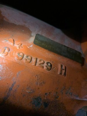

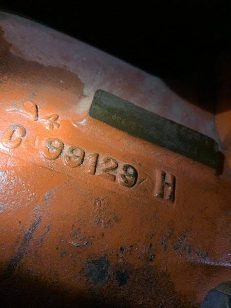

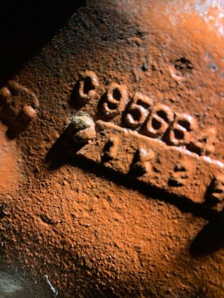

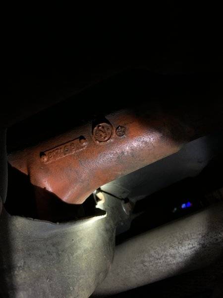

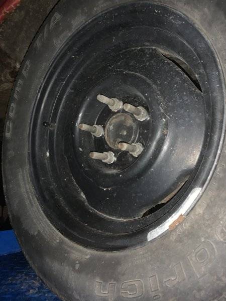

Hi started the thread in Welcome Wagon about the new to me Satellite. I got under it and got a few pictures of engine transmission and Differential. Anyone able to decode them for me?
E55F3BD6-2F79-482D-A934-17B990E354F7.jpeg 3356D9CB-6F31-4FAA-905E-03D0C40794B0.jpeg 4E0BDE4B-BFE0-4618-B3A5-8FFEFA4549C5.jpeg B04A75CD-AE5D-4535-9330-4C8FE6A2F582.jpeg AA0AF180-2287-4D28-84D8-87C4A396D070.jpeg AA014716-826A-4157-8FAB-325E753E52BD.jpeg DCC4A91B-399D-4B97-8ABF-9A9E3D606240.jpeg EFF0354B-64C6-4ECC-A00B-B1282E4885A8.jpeg C1C45826-8222-41CD-8A6D-6B4ADA473B73.jpeg AD56731E-62FD-4EB3-9006-27AE174D8738.jpeg
383 motor with later 8-3/4 rear that has the heavy duty tapered pinion rear axle. Looks like its been to the drag strip? Does that help? :thumbsup:

Post the numbers that are on the trans. pad shown in the second picture. In front of the passenger side cylinder head on the engine deck surface there will be more numbers and letters. They will tell you the model year and build date of the engine.
I’ll try and get a picture tomorrow. Thanks again
