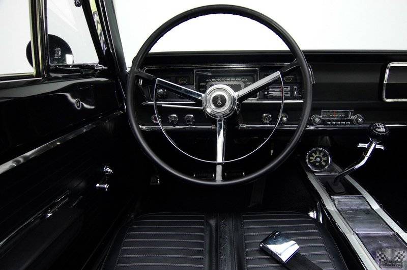

a 1967 Plymouth GTX that has a factory console tach. or a Vacuumtach… It was a special order from acc…..
Wiring….The green lead goes to the distributor negative side, the orange wire is for the internal light, the black wire is the ground, and the violet wire is the positive voltage supply.

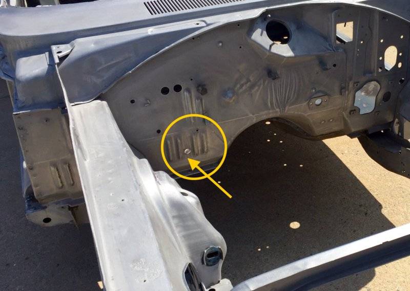

Just need to know if it was like the 68-69 style a 2in pigtail trough the firewall with a connector to the coil lead
My 67 R/T has a hole over on the passenger side under the heater box. Factory tach and wire.
