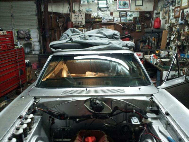

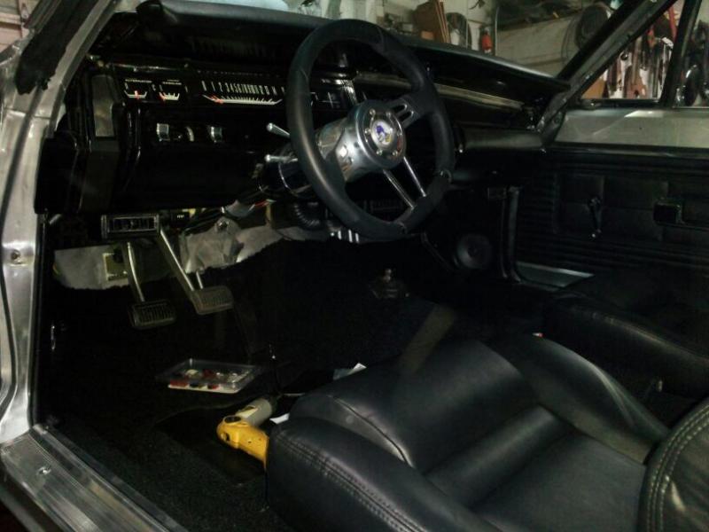

new windshield and dash cluster installed. I've still got a ways to go but I'm happy with the progress.

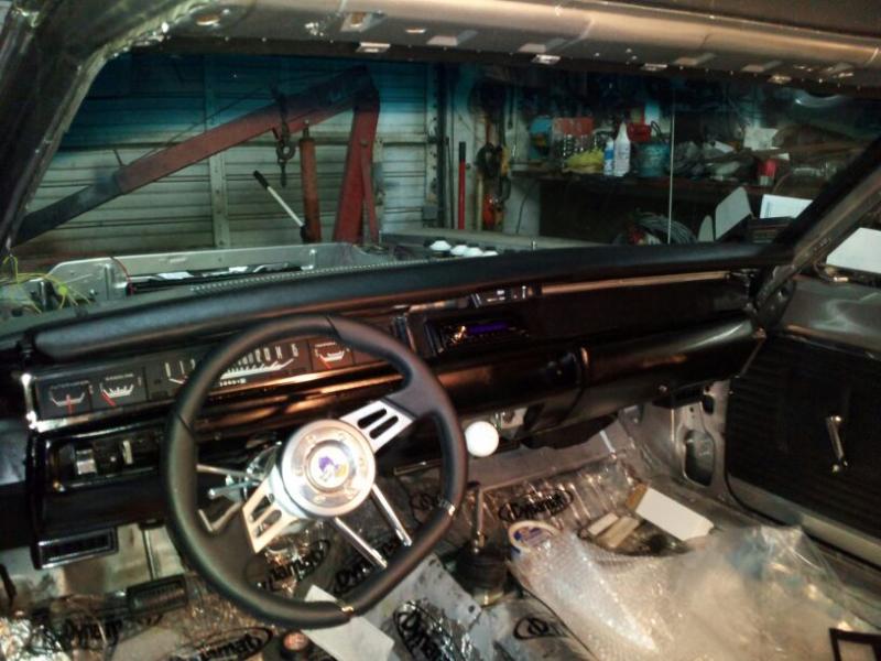

How's it coming Drew? The steering wheel is really cool looking esp with the RR hornbutton. What brand is it?
It's a flaming River column and steering wheel. I'm using their drop down bracket instead of the factory stuff. It looks like it's going to work great and it wires up like a Chevrolet truck but it includes the wiring diagram to adapt the two.

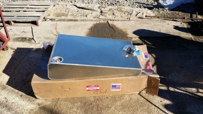

I've been doing some interior work lately. Carpet,kick panels with some 6 and 1/2 in speakers and the sill plates installed. I've got all my accessories for the engine so I guess I'm just waiting on it. I also ordered a new gas tank from Hot Rod City Garage. It should be in by the 12th.

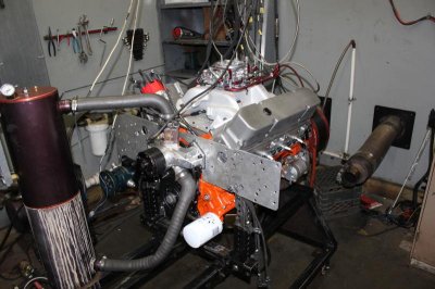

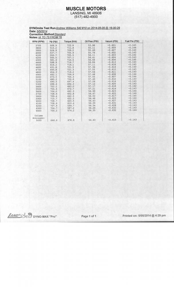

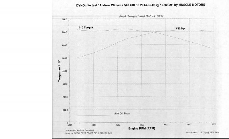

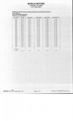

Finally hit the dyno. It should be a good time :headbang:

drew looking good, nice combo, nice parts & pieces, you'll love it I'm sure, interior looks really nice too
