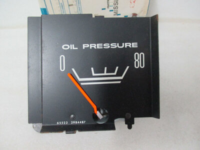

Does anyone have any knowledge of this gauge for 68-70 B bodies with standard cluster? I just purchased an NOS one and cannot find a wiring diagram in any of the literature. I was wondering if it gets the standard 5v supply from the voltage limiter like the standard gauges or if it gets a 12v supply since its an optional gauge? Any help would be much appreciated.

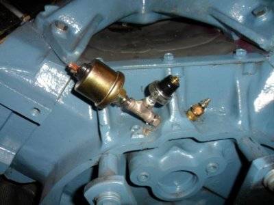

If you want to keep the light along with the gauge, will need to install the sender on the other block provision and wire it individually straight to the gauge ( or use a T or Y pipe conector to use both senders )

Thanks for the reply. I just installed a Hemi in my 68 road runner and I want to monitor oil pressure but I didnt want to install and aftermarket gauge. The old school sun super tach is about as far as I want to go.

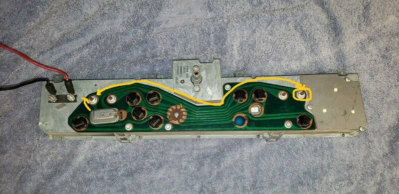

here is the 68/70 rear cluster view and the source from the VL... so there you have the closer point to take the 5 volts to feed the gauge... the outer temp gauge stud

then the wire straight from the gauge kind sender.

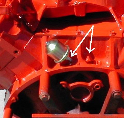

This is the block provision... somebody used the extra one on this block for a mech gauge
so just get the propper Sender. Be sure to be 80 PSI, since there are also 100 PSI available, althought 80 PSI is actually the regular one.
and install it on the extra provision on block... OR replace the light sender for the gauge if you don't want to keep the light.
Or:
which I think is stupid and ugly LOL
