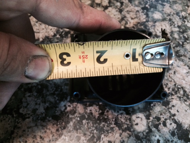

Does anyone have a 68-70 B body dash defrost vent near by that they can measure the OD of the round plastic part the defrost hose slips over? The heater box end is 2.5" but I'm thinking the vents are 2 1/8? Thanks,
FullSizeRender (55).jpg Sorry about the picture, not talented enough to hold the tape, piece and take the picture, I measured them( repops) looks like about 2 - 7/16"
Hi, thanks, I sent you a PM. I was almost sure the originals were smaller. If anyone had an original to check? I could be wrong. I do appreciate the help seventy & Mocajava!
I'm pretty sure mine are originals.... They measured 2 and 3/16 inches outside diameter... hope this helps. :)
Yep, that helps. I was pretty sure originals were smaller then the repops. I just tried to measure mine the best I could as they are still in the dash. Thank you TDawg.
