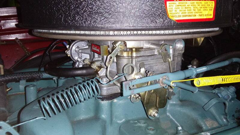

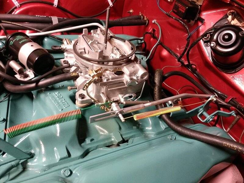

2. Looking to see if I'm able to reposition the throttle return spring onto the linkage with the
correct spring (green with orange stripe) rather than the way it's currently mounted.
Thanks! What has me confused is it looks like the spring has to connect to the carb like it is on my style carb to activate the secondary's vs. the cable.
Also can you post a close up picture of the yellow spring. I want to see the red so I can find a paint that matches.

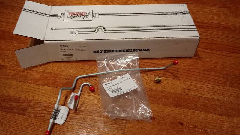

So I placed the order with Dr diff. They said their lines are custom bent by RSD. 3 weeks due to short staff. How is their quality. Now thinking I should have ordered thru in line tubes.
My track record with In Line Tube has not been great, but I also realize I'm in the minority on that opinion in this forum. I had 6 weeks of delays due to In Line sending the wrong items.

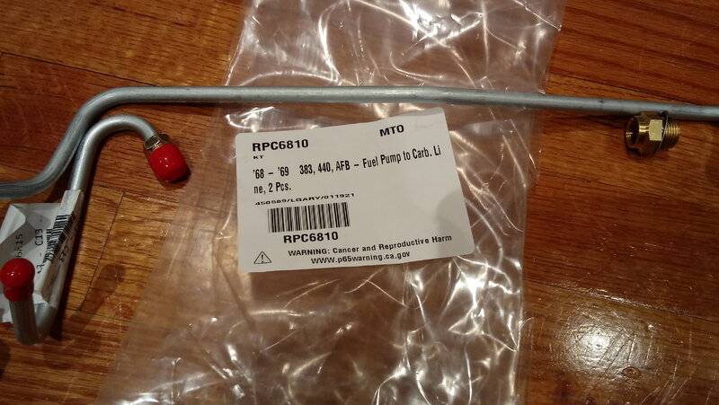

Got my fuel line today from Dr. Diff / RSD. As I have a Edlebrock carb 1411s I ordered the AVS line but they sent me an AFB line. What if any difference are there between an AFB vs. AVS line?
