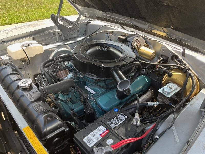

Just bought my new to me 68 Charger. The front has been converted to disc and rear is still drums. When I got the car delivered today the right rear drum seems like its stuck, and the brake pedal is hard with very little travel. What could cause this? Maybe air in the line and adjust the rear drums?

That picture illustrates a Four wheel drum brake Master Cylinder , so you may have even more problems than you signed up for ……

I agree now looking at the master cylinder that looks like the one I had with 4 wheel manual drum from before I converted to front disc/rear drum. When I changed mine over to disc I used an adjustable Porp valve instead of the disc one that some change to.

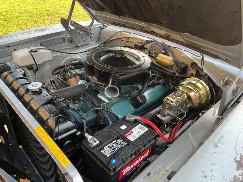

So got it fixed, booster was bad, got the correct master, and prop valve and works great. Guess the last owner didnt know what he was doing when he did the disc brake conversion.

So got it all fixed, bad booster, wrong master, wrong brake lines, no prop valve, wheel cylinders where bad and leaking. Some people don't need to work on cars. But got it all fixed.
