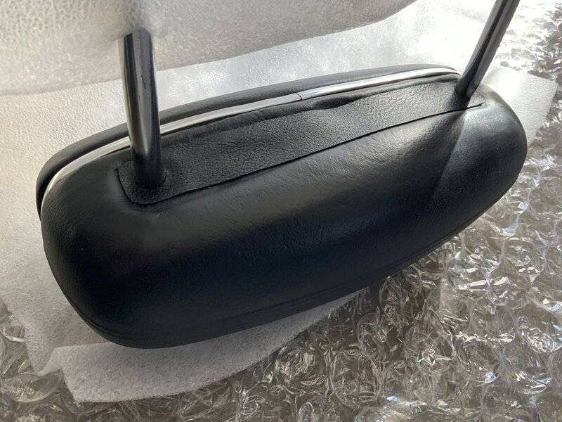

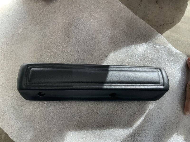

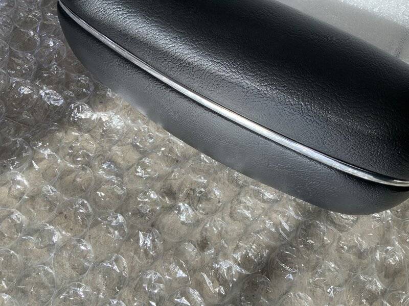

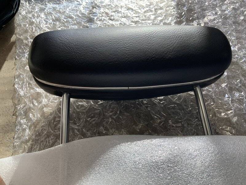

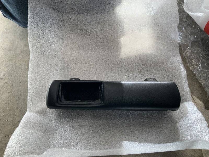

Hands down just dashes , will take time be patient but not the others on the dash if u are looking for originality they don’t do the stitching. Will cost some $ i had all mine done and head rest, arm rest,glove box, center ac pad real good quality work. But on the glove box and center ac pad came out more round and not square Enough fort me as the originals. Also mine are for a 69 charger took 9 months and still in box (black).
So here are a couple picture I have I didn’t take any more i can. U can see through the vinyl the faint sticking from the original arm rest detail and that actually looks good gives it to some degree there is stitching. Where i F up is that i should have left it its original color (tan) and i changed it. These will probably never get used.

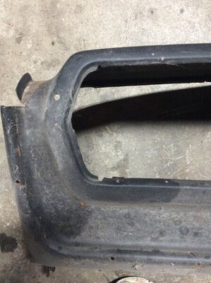

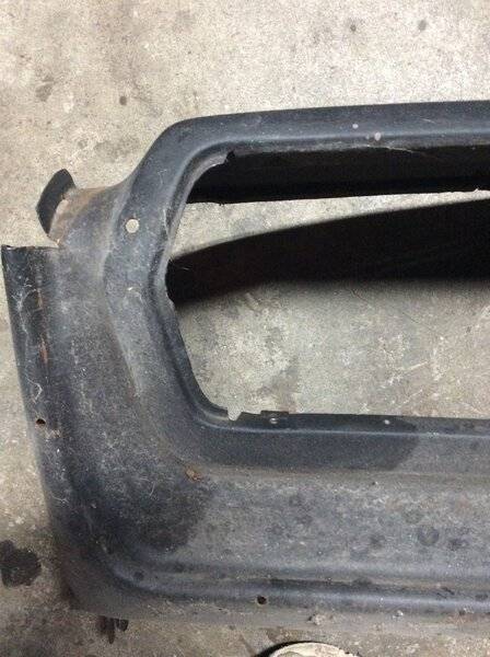

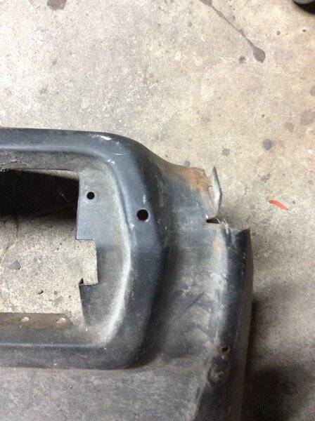

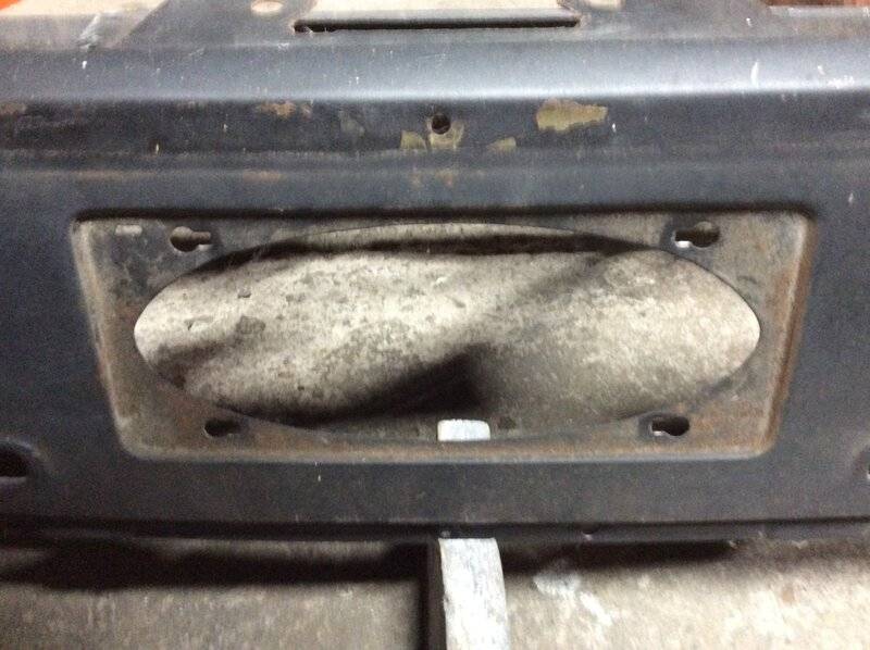

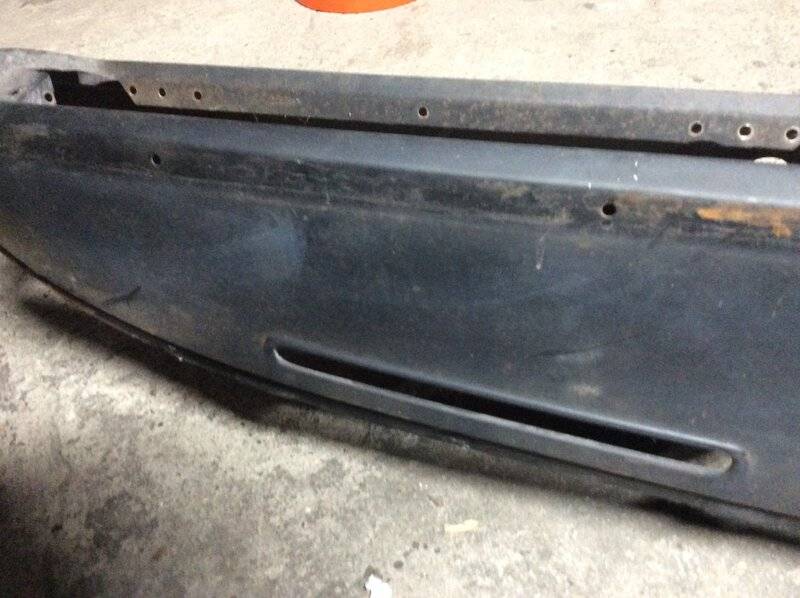

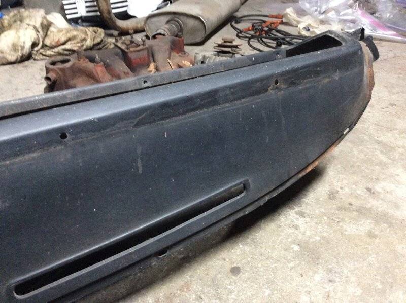

How many speed nuts hold the upper dash pad on and do you have any pics? I’m considering taking mine off and having it restored. Just Dashes currently has my lower dash pieces in line for restoration.
I count 7

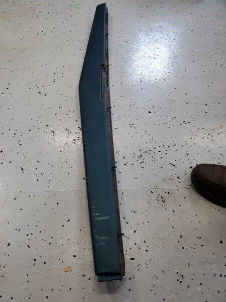

EDIT: So sorry. This dash is from a 67 Satellite. I should have read the post better.
F1E4E0AF-0FD1-4800-AF40-96CC1FD65766.jpeg 4EA1BFF3-C1ED-45DA-981E-5C08AB6418F1.jpeg 423648F9-C445-4DEB-BCEA-57755AC4CD37.jpeg F4A34ABC-3EE4-4166-9F8F-2AB3E84878CE.jpeg 7B3EEDA5-B8A2-4A38-BDD0-E31E5D3D710B.jpeg
