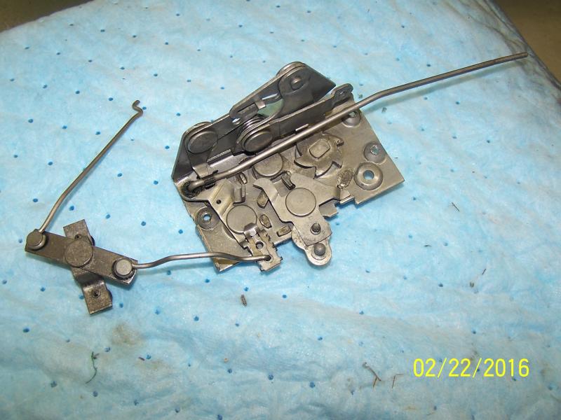

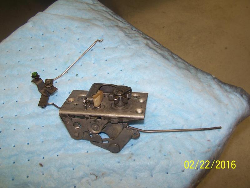

I am trying to assemble the window and lock hardware in my 68 Charger. I did not take it apart but I have an idea of how to put it together. I'm running into a couple of issues. The first is a replacement felt for the lower window guide In the back bottom portion of the door. It guides the metal frame of the window. Does anyone make a replacement felt? If not, what should I do?
The second question is in regards to the door lock pulls. I have the pull rods but it looks like i'm missing a part that completes the link between the pull rods and the locking mechanism. Can someone explain what i'm missing? Thanks!

Here are a couple pics of the door latch assembly showing where the rod connects to the mechanism. You are probably only missing the clip
