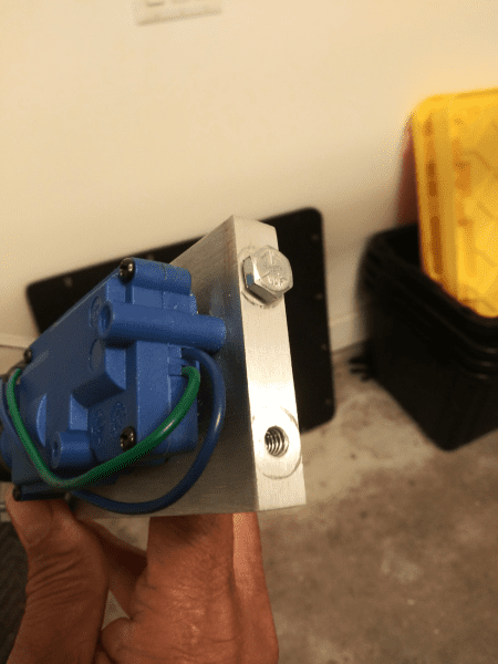

On my 40' Ford Pickup I needed to add a way to lock the doors. The stock handles operate aftermarket latches with no lock mechanism. I cannot remember the brand but the pics will give you an idea of the quality of the pieces. The solenoids are mounted to a beefy aluminum block. The install requires some fabrication of course. I added a steel cable to one solenoid routed to an area I could reach should the battery die.
A corresponding hole in the door jamb is necessary. I added an aftermarket electronic door lock fob to activate them. Works nice.
