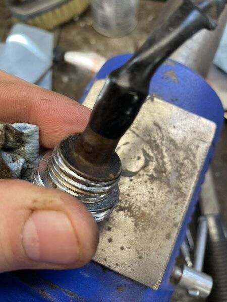

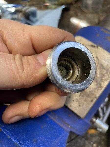

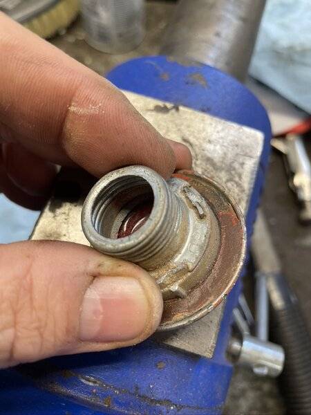

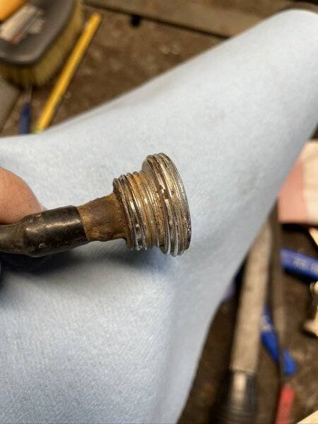

The parking light housings in my car are different front to rear. I know the car was in a front end collision many years ago, so I don't know if these are all original to the car. Here are some pics showing the differences.
The fronts screw apart and the light socket does not remove from the base. The metal socket is formed into the threaded part. It will spin but not come out without breaking stuff.
Fronts:
The rears are a different construction. The pigtail with the bulb and socket clips in to the housing. The housing is one assembly that is staked together.
