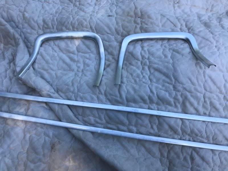

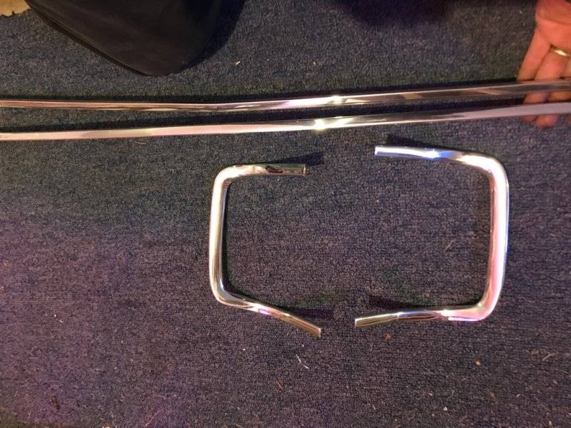

As recommended, I first removed the Cadmium plating from my '68 grill surround trim, then polished the four pieces. Here are before stripping, after stripping (6 min. in concentrated Lye), and after polishing with tripoli, white rouge, then jewlers rouge. QOTHL, thanks for encouraging me to do this process!!
