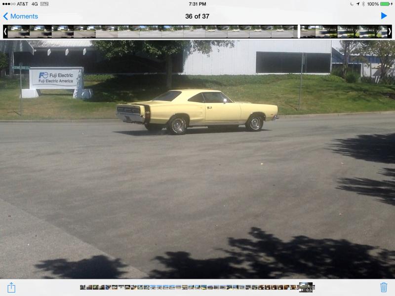

I own two late model Mopar Hemi R/T's. I prefer driving the 69 Coronet. With subframe connectors, upgraded brakes (not discs), tubular uppers, firm feel box, Bilsteins and radial tires, it feels good at triple digits. This for far less coin than the major stuff described here. Still does not handle like IRS etc and that's ok. Drove it today. Going to Reno next week. Travel in a modern car is boring. I accept the new technology and have air, pw's, Valentine 1 radar, dash cams and navigation. Personal preference here. image.jpg
