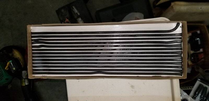

Yes there are dabs of Butyl in the recess area around the arm rest area n in the recess area towards the front of the door by the door handle.Send me a PM IF you need pics
Is it just the black tape at the bottom or also strips of rope caulk down the side?
Place strips of this between the poly and the metal where you need to keep it in place.
