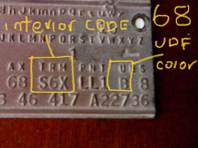

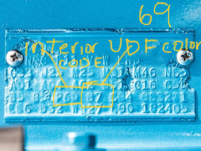

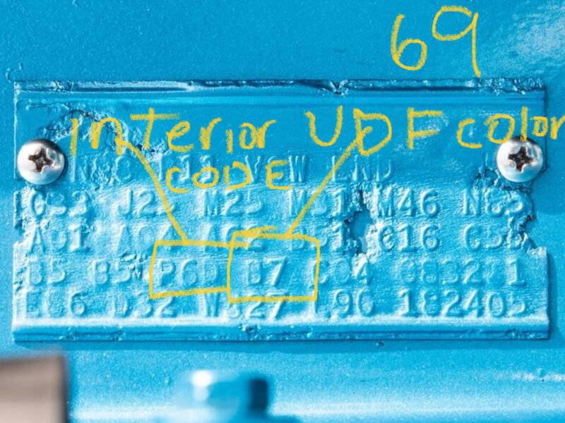

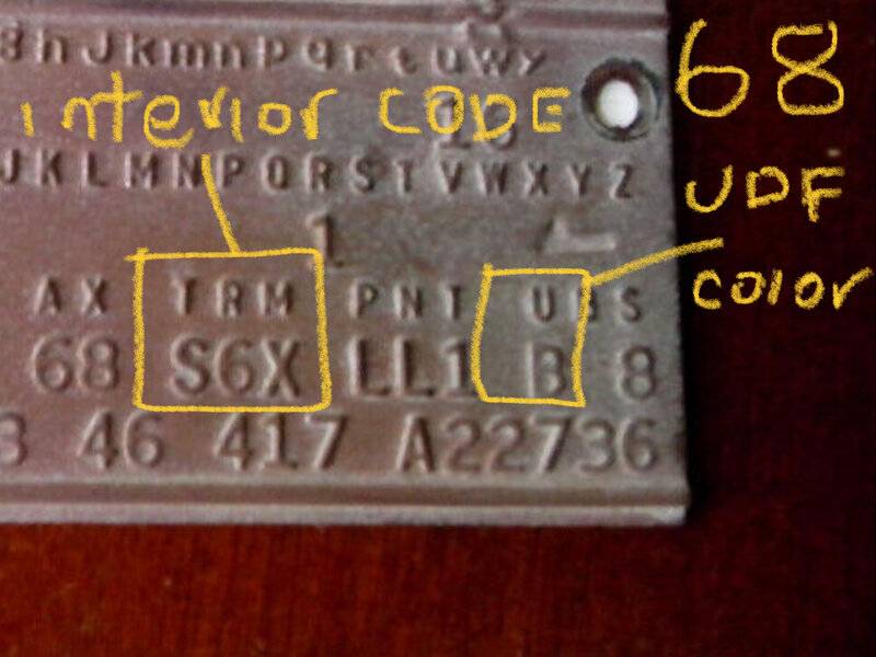

This code is on your fender tag and build sheet if you have it. it’s under UDF on a 67-68. Post a photo if you need help decoding it.
When you see these painted in hemi orange, plum crazy or sublime green it totally wrong.
see photos for 68 and 69 examples. Interior code tells color and vinyl cloth leather, and seat type bench or buckets. UDF is the color of the inside of doors and rear quarter top metal piece for 2dr. Or center door post on a 4 door, and doors and all around inside of glass on a wagon.

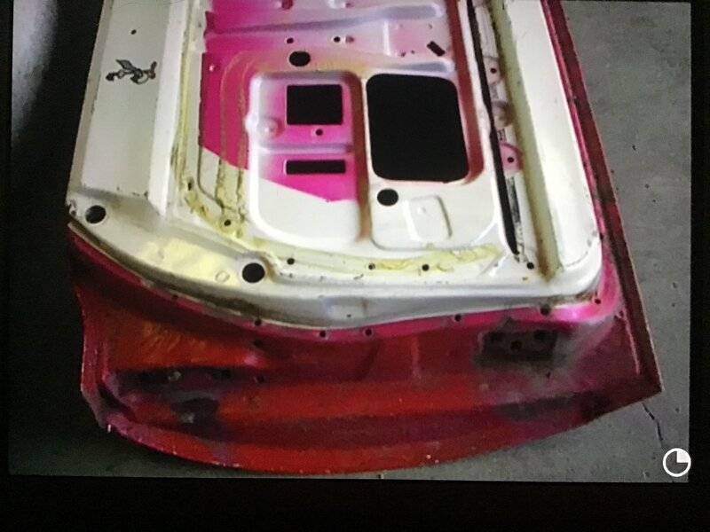

Here is a pink door with white UDF paint. This shows how the factory did it. The color difference makes it very self explanatory. Chargers with upper door pads were like this also.
The car was painted red that’s why you see that in the door jamb.
