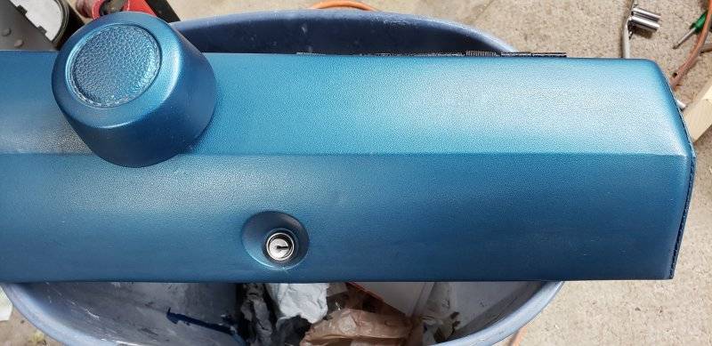

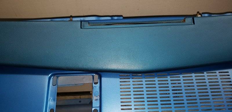

I have a 68 GTX and went through the B.S. matching the colors. If you post some pic's using your
flash I may be able to help? Here are some pic's of my parts: The teal is for the dash pad, B pillar covers, console, and arm rest pads. The Bahama Blue is for the dash.
There are 4 different blues, and the shades of the darker blues didn't match exactly when they were new.

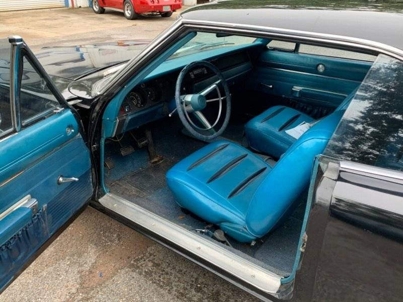

Heres a couple pictures of interiors is part of the reason I am baffled. All the Dodge sales info (including fender tag) I read shows interior color as Blue! Some other documents show colors Bahama Blue and Light Metallic Blue used! I am a lot further along in my understanding now tho!
Here are some pictures I got from the internet. Looks like in a couple of these pictures the upper door panels are dark. Maybe its the lighting or maybe an incorrect restoration?
