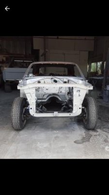

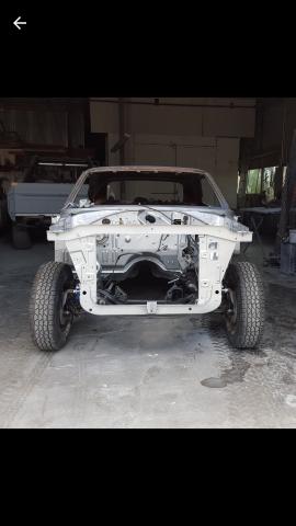

Well this is my 68 project slowly but surely it is coming together doors and fenders ready to be reinstalled as soon as I get the new bolts in. I rebuilt all the door hinges with new pins and bushings so the doors will open like new. Had the engine bay blasted and painted and while all the suspension was off the front I had all bushings and everything rebuilt and added a "right stuff detailing" drilled and slotted disc brake conversion.

BEWARE OF THE E-BRAKE CABLE ISSUES!!! i am using the same kit and they are a PAIN in the *** to get on the phone and find the right cables. the 36' ones included in the kit are referred to as "generic" and will nned to be swapped out for oddball lengths to get the correct fit.
