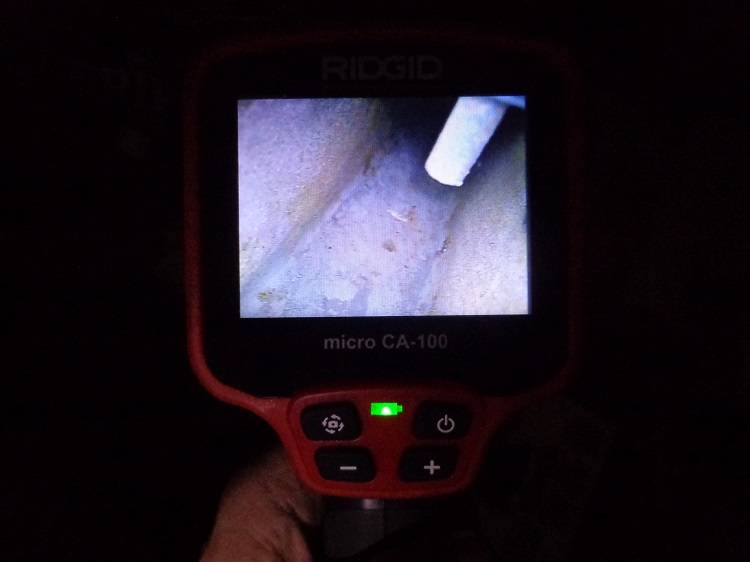

Ok, I have a 68 Charger and am curious about two things. The sending unit in the car has two line outlets like it is designed for a vent tube hookup. The cars vent tube coming off the filler neck dumps down into a groove in the frame rail and just stops. It doesn't look like there are provisions to hook up to this and run it to the sending unit. Is the sending unit only supposed to have one nipple on it for the fuel feed and that's it? Is this fuel vent line on the filler neck supposed to be attached to anything, or does it dump into the frame and just vent the filler tube? Anyone have any pics of the correct setup under the car?

Picture inside the frame rail of filler neck vent tube exit end. Yea I have nothing else to do some days except to test new equipment.:luvplace:
