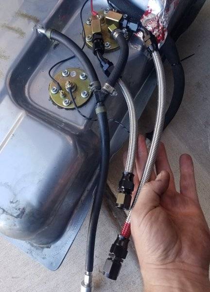

Tank is a Holley EFI tank, 3/8" feed and 3/8" return from Sniper EFI. There are two vent hoses, one coming off of the fuel pump mount and the other off the body of the tank that go to a Y connector then to the vent. I have the vent mounted as high as I can get it in the rear end tunnel.
Problem is it still pukes fuel occassionally. Today, I filled the tank to 90% capacity, drove home, got under the car. I then opened the gas cap, relieved the pressure built up and the tank started gurgling and spit out some gas from the vent. Non vented gas cap. Sometimes there is no pressure.
Do I need to mimic the factory vent and run a line with a loop in it up into the trunk and back down? That seems like my only option.

Based on the pic, bring both the tank and sender vent higher into the trunk before joining.

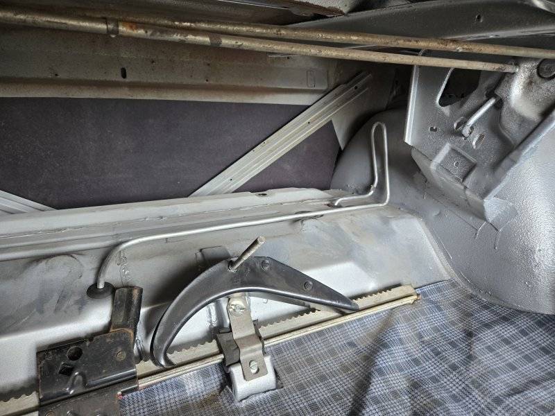

Here it goes. 3/8" tubing routed in the stock location. I'll update this thread to let you all know if it works.

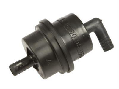

I am about at this point with fuel venting on my car. I was thinking about running a hardline or hose up through one of the grommets, into a standard fuel filter, then back down under the car. The fuel filter should minimize vapors. I think the right thing is to run the line high up into the trunk and back down
The other idea I saw on a GM forum was to inline a Dorman 80195 filter in the vent line. This is a small carbon filter used inline on the brake booster of a 1980 Corvette.
Update. I've been driving it a few times a week and have not had fuel pissing out of the vent, nor has there been any pressure build up in the tank. I think it worked.
You just routed new vent tubing?
I routed the vent up into the trunk and back out with 3/8 " tubing in the factory location. Vent loop is higher than factory. It seems to work.
