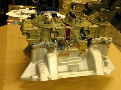

On a side note, was thinking about the engine, doing a dual quad carb system, but every time i see one a six pack makes me feel all tingly inside..... The motor i wanted to build, im getting a 440 block, bare, i wanted to bore out and stroke to 505 if i buy a scat system, otherwise 440source has a 512 kit, but above that requires more $$$ for external oiling system, although i here some members on here have noted quality issues with 440source?
Anyways, maybe some Eddie ported heads if not from the 440 source, and everywhere i read, a single or a dual quad system wins out for simplicity, and sometimes even power, but dat six pack.... just debating in my head for now. even a regular 440 six pack i wouldnt be bothered by one bit just for its authenticity, but i wanted the engine i built to pack a little more oomph. ive built several recip engines in different applications but the car as a whole is the magnum opus, and i wanted the engine to reflect that mopar muscle. i have yet to delve into the cams and some of the little niggly bits yet, but theres plenty of time for that.

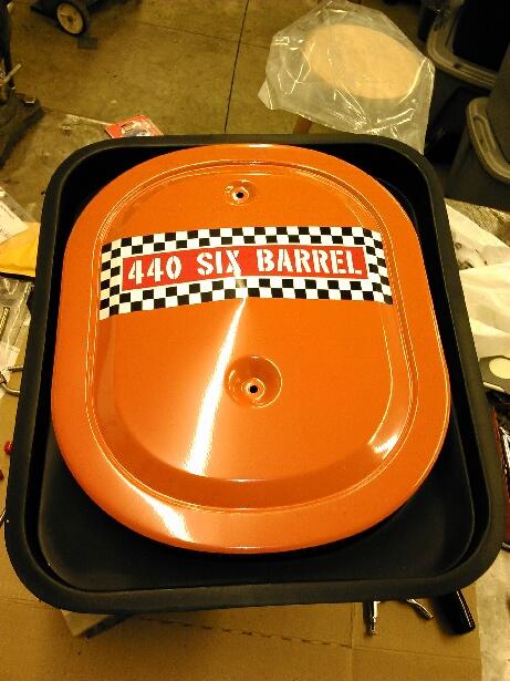

I vote Six Pack, plus better MPG if you keep your foot out of it. That's whats going in mine!IMG_20151121_150124.jpgIMG_20151125_173035.jpg
