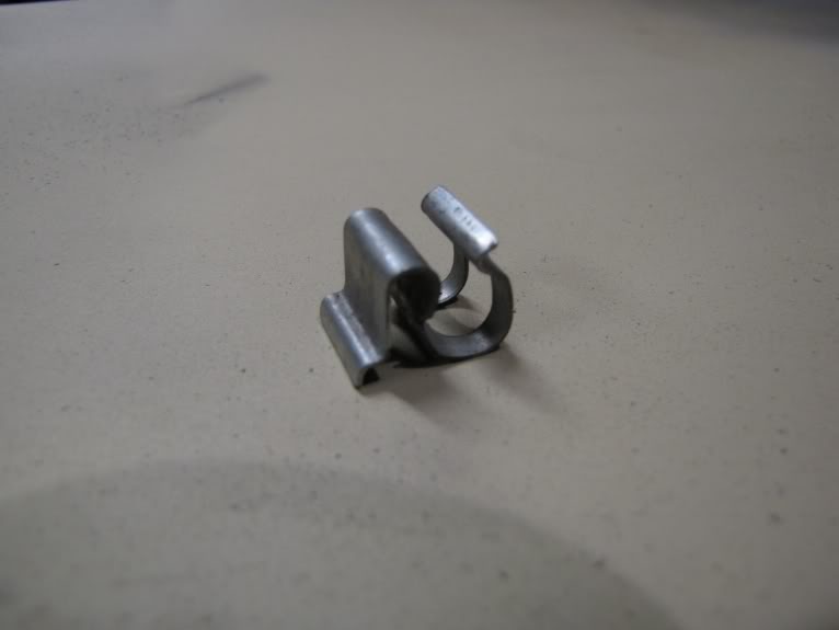

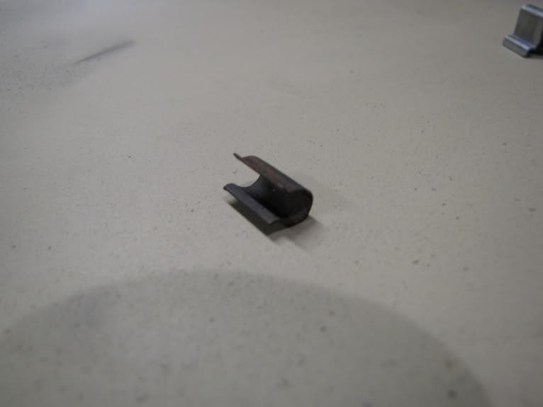

Hello everyone I am going to be installing my headliner and I am not sure of the clips that I need to use. Also how many does it take. I know there are two types of clips the u shaped ones and then the larger u shaped clips that also holds on the trim that runs down the windows. Does anybody have a picture or be willing to sell me the trim clips that hold on the long pieces of trim. I need to know how may should be there also.

(1st Pic..........Clips to hold the trim. Exact factory number them? I installed 8 on each side on my RR. About that when I took it apart initially.
(2nd Pic.........Clips that secure headliner to roof pinch lip. Exact number of them? Probably at least a dozen each side on my bird.
R/T Specialties, Megaparts, Ebay, YearOne and a lot of other places sell these..
Good Luck

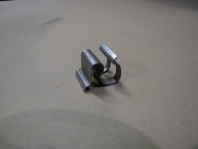

Good Luck
Yep on the big clips and i just used the 3 per side like the factory did with the small ones,but it is also glued from the A pillar all the way to the C pillar as it wasnt from the factory
Hey thanks so much that answered my question perfectly.
