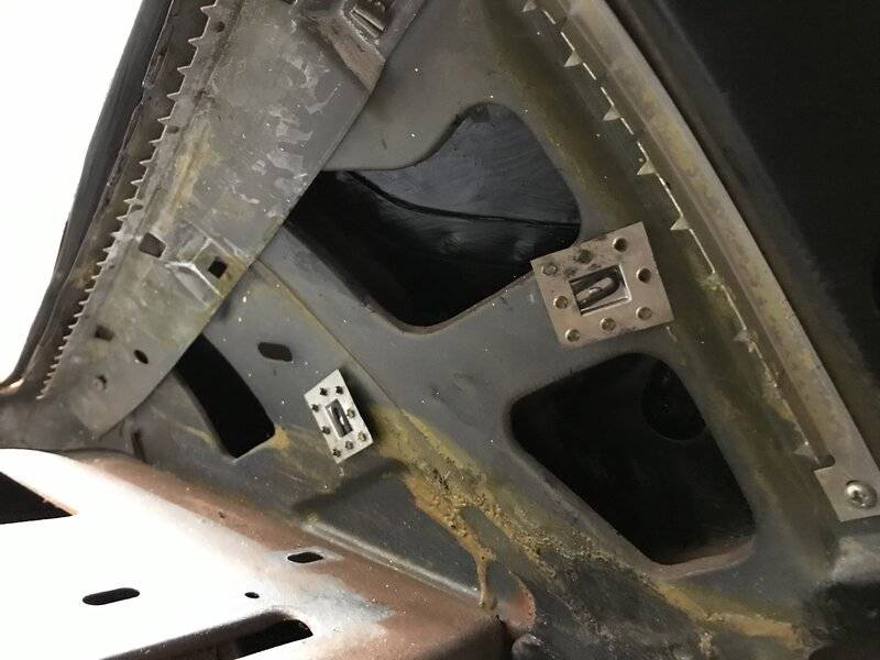

I have read through some old posts and I believe it seems as though most say the '68 did not have the sail panel boards. I brought my car in 2010, so I can't say if the headliner was original or not. But my car had the sail panel boards and headliner ended at the teeth on the c-pillar. My questions are
1. If I were to make the headliner go all the way to the rear deck. Is there anything other than glue that holds the headliner past the teeth on the c-pillar?
2. If just glue, what type of glue is used here? Something like Super 77 spray adhesive? I have seen mention of using contact cement the edges of the headliner by dadsbee in his thread on DodgeCharger.com.
3. Or should I just go with installing some sail panels and save my self some aggravation/headache? I still have the metal square metal plates and clips that were on the sail panels when I got the car.

#3 is your best bet.
A headliner gets pulled tight and then put over the teeth to secure it. How are you going to pull it tight and secure it with no teeth?

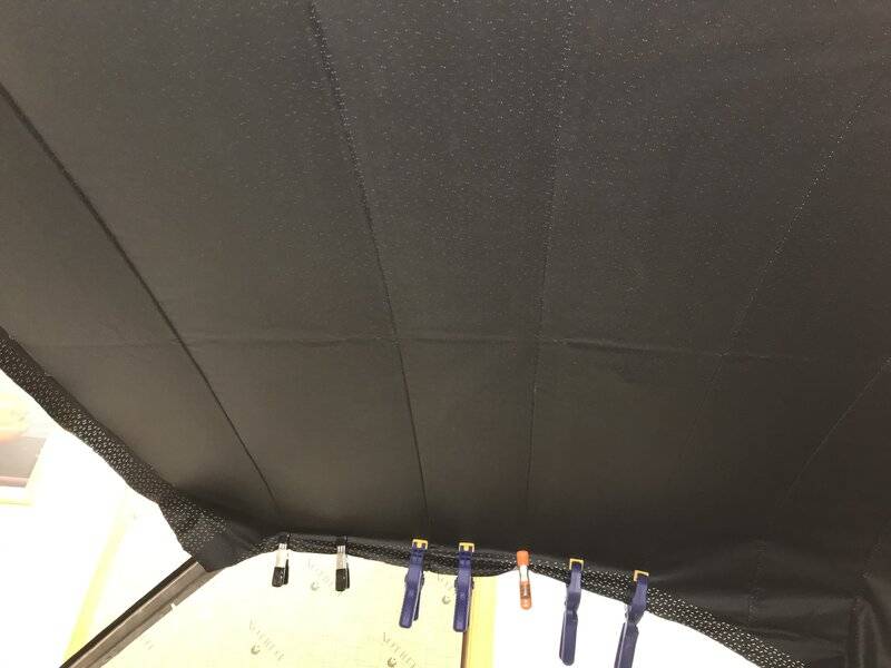

So I got around to starting on my headliner this morning. I have the front of the headliner pulled tight and tacked along the windshield. Then I have about the front half pulled tight and held in place with spring clamps on both sides. Since my headliner was sitting in a box for 8 years, it has quite a fold down the center that even when pulled tight is still very visible. You can see it in the picture below. I don't want to spend much more time on this headliner right now because i am not sure if the fold is going to come out.
Does anyone have any idea if this kind of winkle/fold would come out with heating it or steam?
