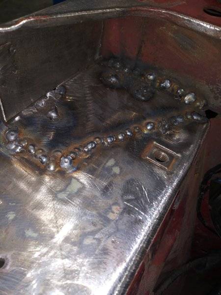

@ckessel My Hobart 135 requires quite a bit of finessing to weld thinner sheet metal. I actually start about 3/4 of an inch away from the target, pull the trigger as I move the welding tip towards the material. This is sort of like having a 3/4 inch wire stickout but the movement keeps the gas at the weld. This technique seems to work when I start blowing through the thin stuff. I have never tried Tig. It on my list of things to try.
My MIG is a Lincoln Power Mig 215. I dropped down to the .023 wire and corresponding liner as a fix. Same story. Place I worked at some years ago had an ESAB unit similar to mine. I could weld on sheetmetal no problem with .035 wire. Currently have .030 in it. The TIG is going better, it's just been 3 years since I did any plus I'm in weird positions so I have to stretch out and toe the pedal. I have a finger control, no reostat-on/off only, on the machine but since I got a replacement under warranty, I only recently found the connection to the machine is different. Can't use it now. When I get a chance to upgrade my machines, I'm going to get a finger control that duplicates the pedal for amp control.

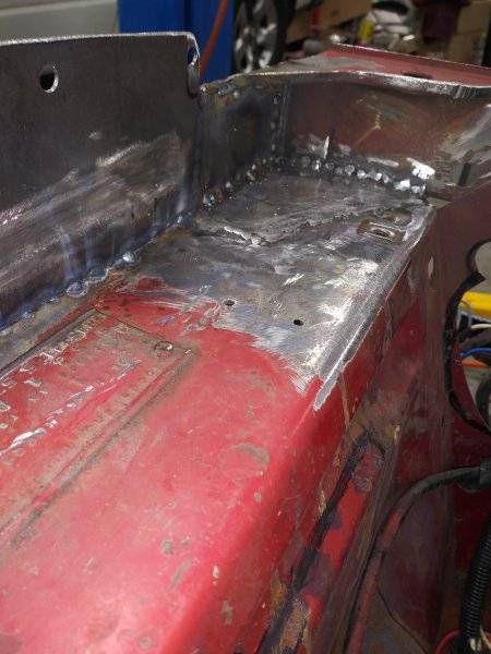

That's the thing with TIG I didn't quite understand. The toe pedal would make it difficult to access some areas where mig would shine. I didn't know there was a finger or reostat control option. I am using .023 and C25. So far, so good. I still have the torsion bar cross member and both front floors to tackle when I begin phase 2 of this resto. I just started her up after more than a year of sitting. Looking forward to driving the wagon again. This is one of the most comfortable classic car I have owned.

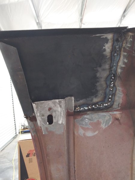

Today, like yesterday, I was stretched out in and out of the car with my boot toe on the pedal. Got about 80% welded, then ran out of Argon. Weird positions and not using a Tig for three years shows but less issues than the Mig. If I had the rheostat type finger control, it would be a big help. Next machine will have it.

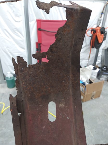

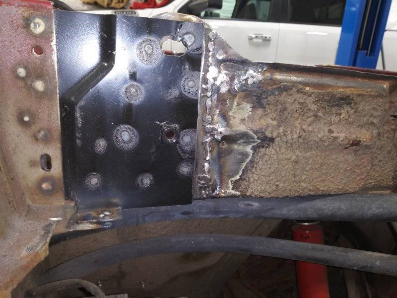

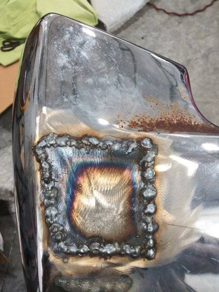

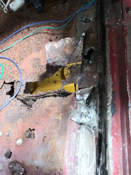

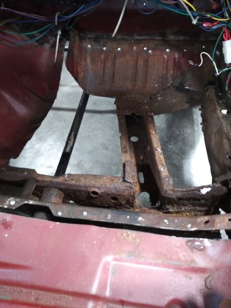

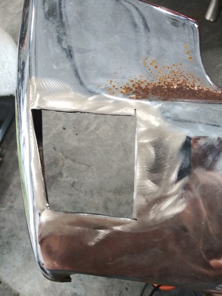

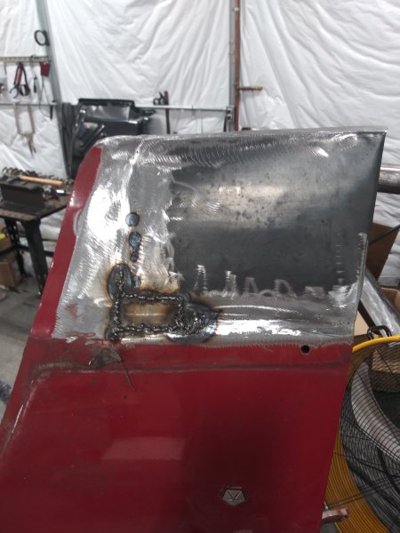

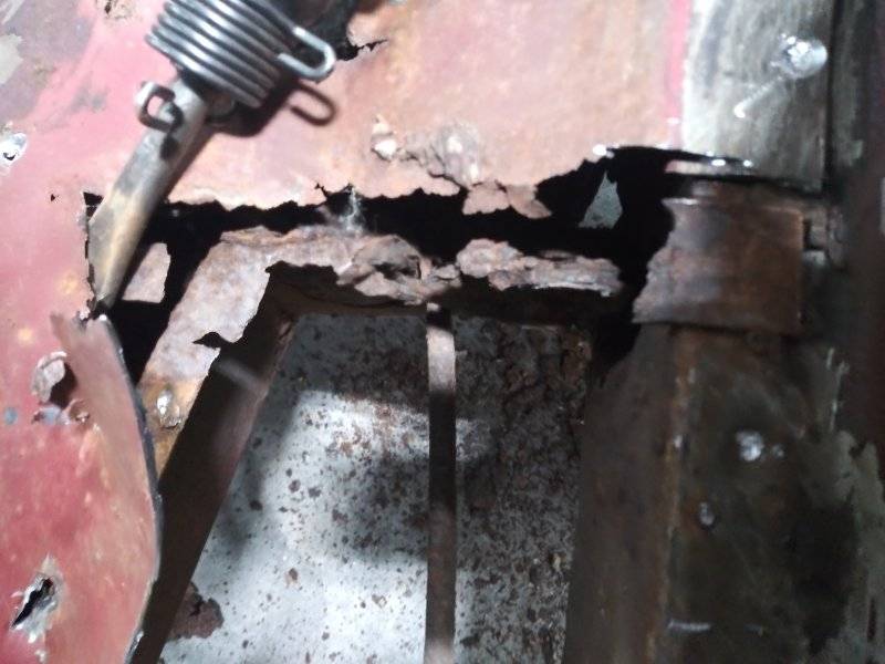

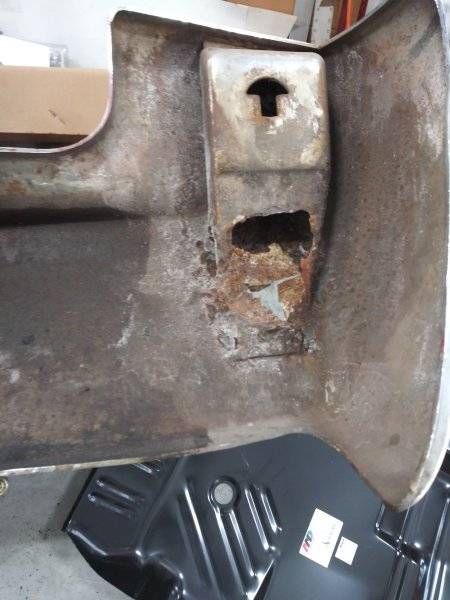

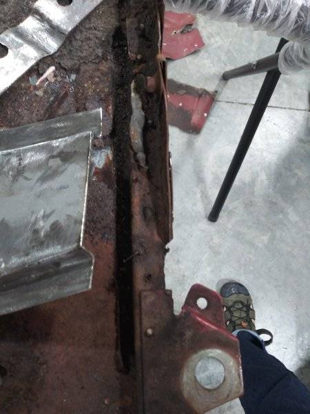

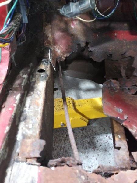

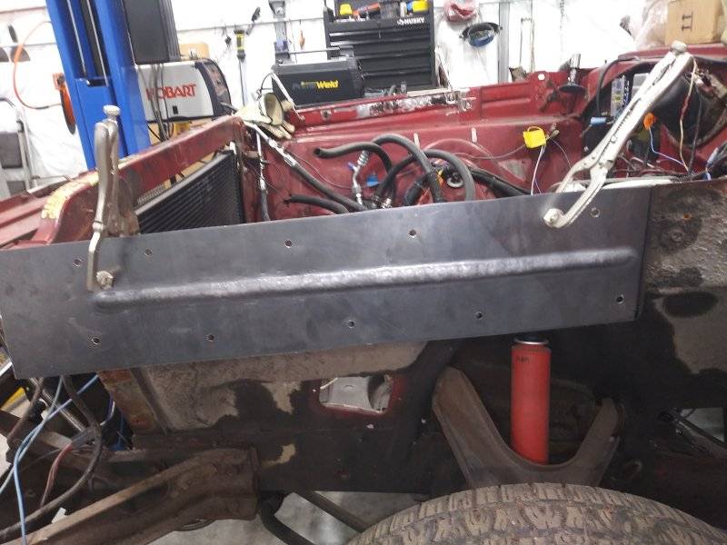

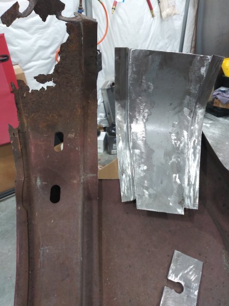

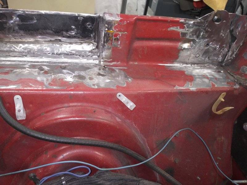

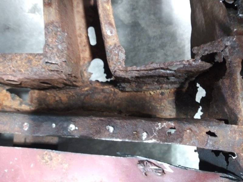

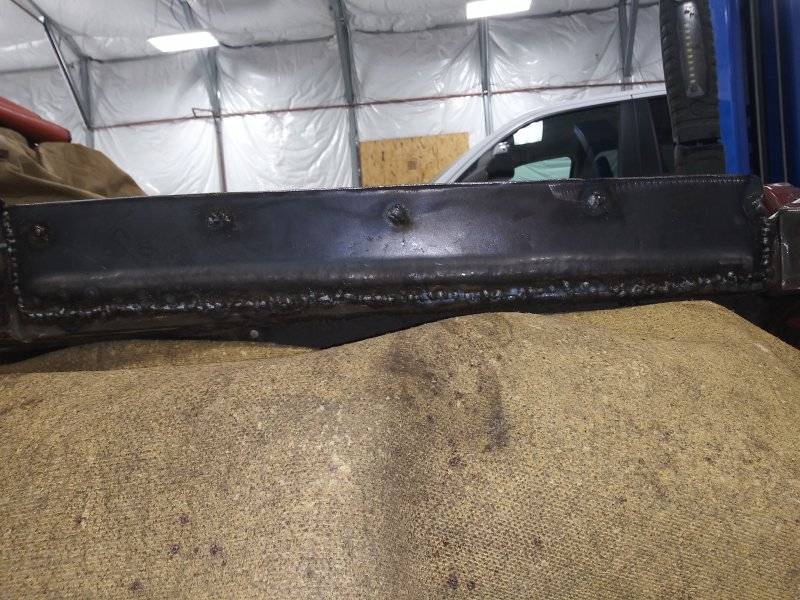

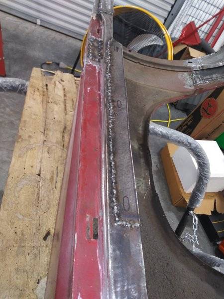

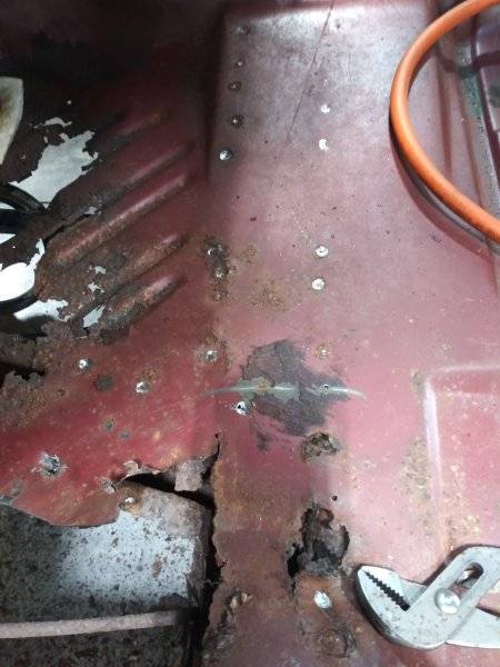

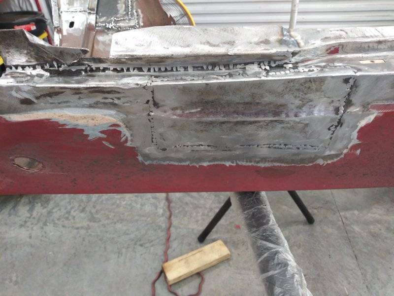

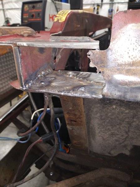

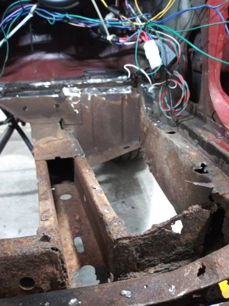

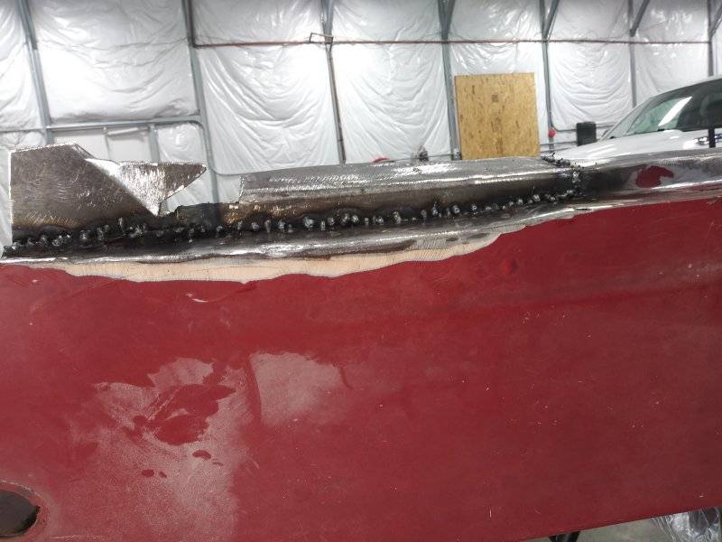

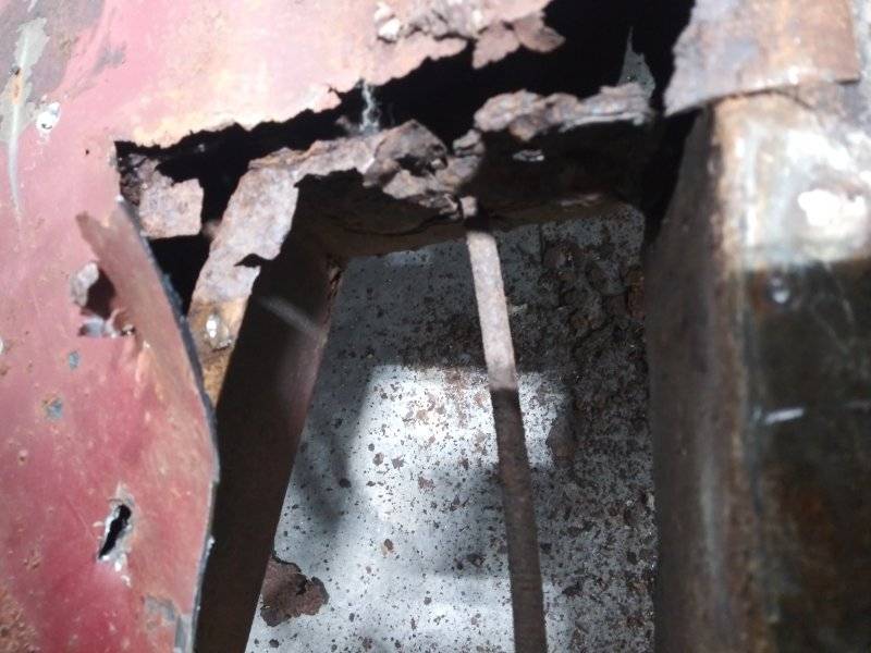

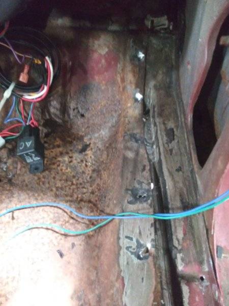

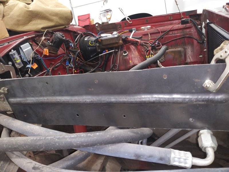

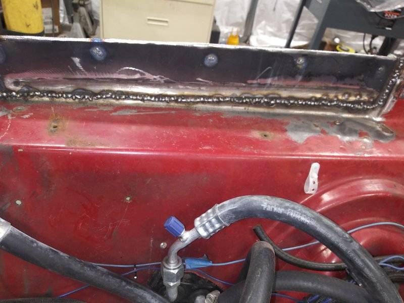

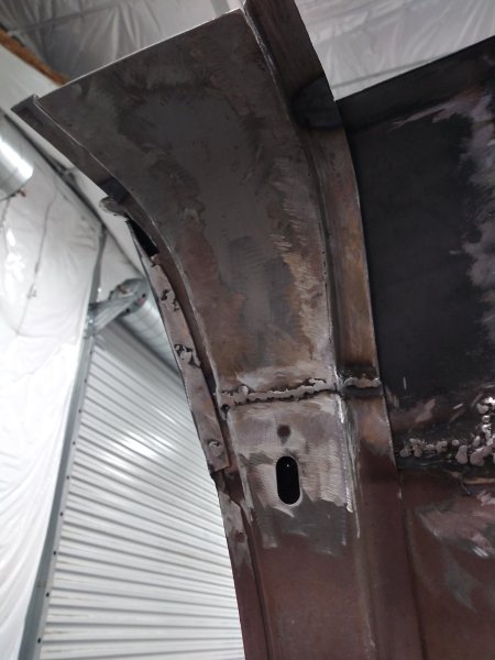

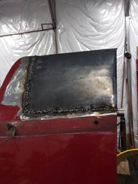

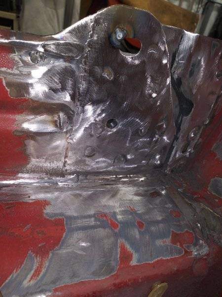

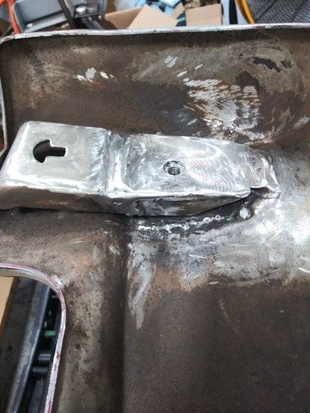

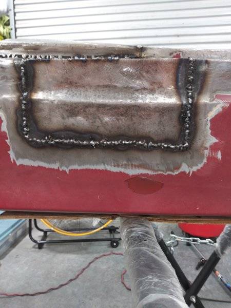

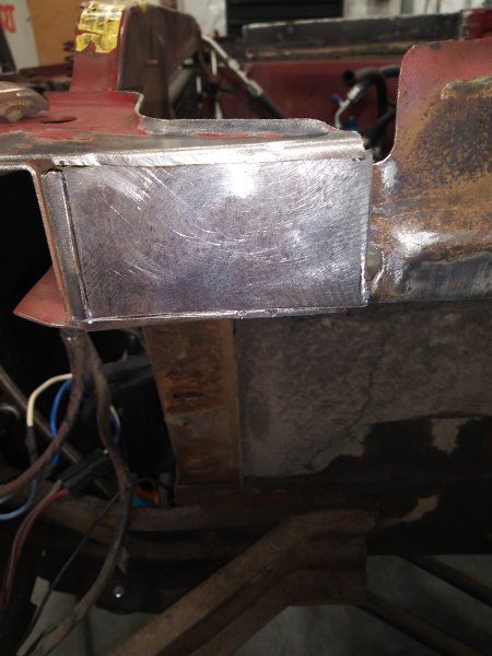

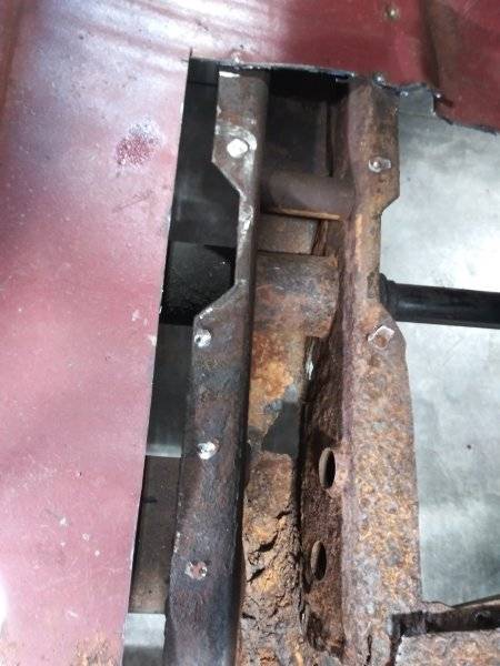

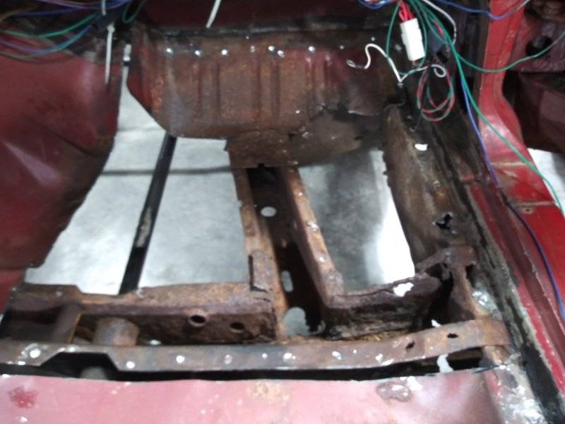

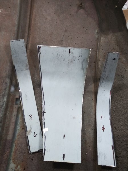

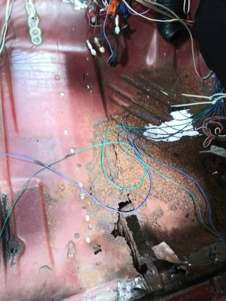

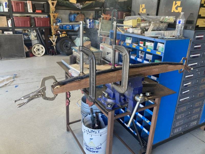

I have gotten back to work on the wagon after some trips overseas. I have decided to forego the road trips with the stroker 390 after it began pushing water out the driverside tailpipe. I installed the 6.4 Hemi using the Holley swap parts. Up next was fitting the A500 in the driveline. I tried to minimize torsion bar crossmember removal but in the end I replaced the transmission "hoop" with 1/4" steel pipe formed to shape with the acetylene torch. I removed the old floor pan footwells to evaluate the areas that will need repacement. The torsion bar crossmember is rusted from the inner rocker attachment to a few inches from the torsion bar sockets. In addition portion of the front frame rails that attach to the torsion bar crossmember will need replacement as well. I am having the frame pieces made locally. While waiting for them, I made the inner and outer rocker panels. The rear bumper had a rust hole that I repaired and sent off to Tri-City Plating in TN. I removed the front passenger fender to discover it needed a few patch panels. I did get a pair of AMD floor pans on sale. Next up is the driver side fender and whatever surprises it presents.
