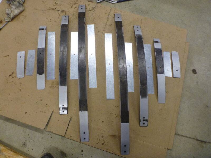

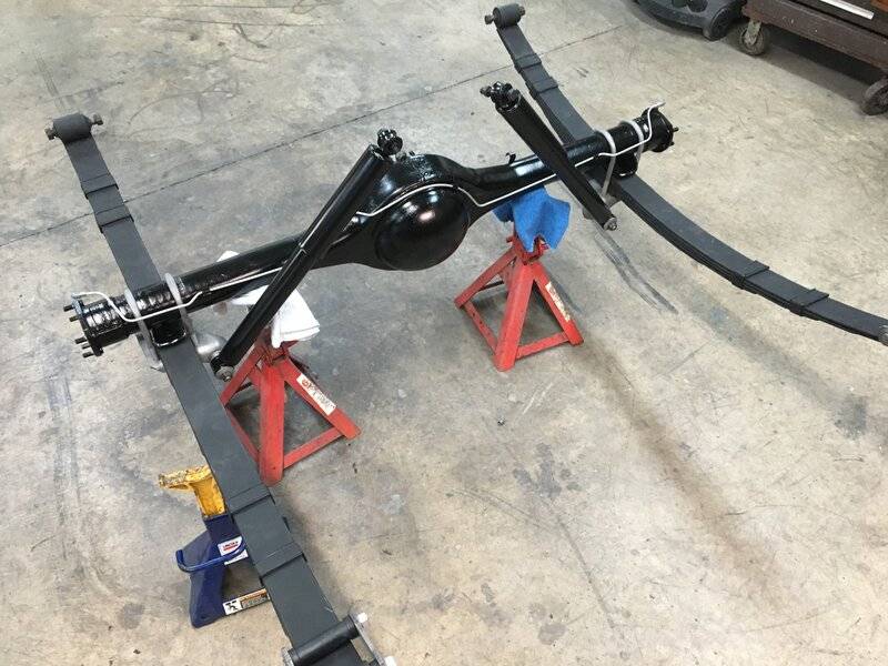

You might just be surprised at what disassembling, cleaning, replacing the galvanized interliners and plastic wear plates will do for them. I certainly was..
