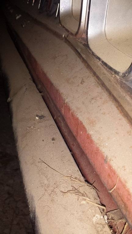

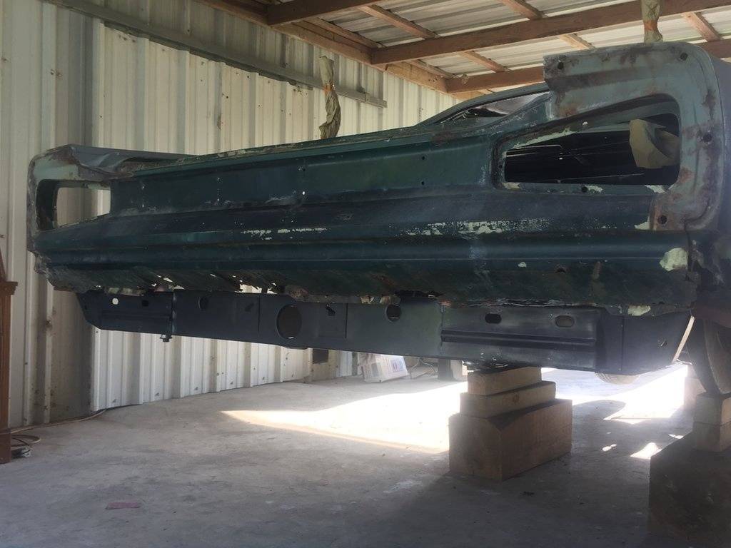

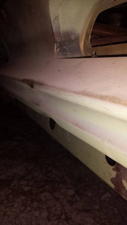

I have both, a '68 and '69 Coronet. They are definitely shaped differently in the back panel. That includes the bottom piece you're talking about. That section on a '69 is more rounded than the '68, plus the ends are different too.
Depending on exactly where the rust is, and if you wanted to get creative you could probably work something out but not sure it would look right.
Thats awesome that you have both models to compare. The rust on mine is at the very bottom behind the bumper. I thought there may have been a chance that they didn't change it behind the bumper from 68 to 69. I may have to try and make something. Thanks for the help
If the rust is behind the bumper and more to the center your plan might work out. Since the bumpers are in place on mine, I really can't say. I'm going on what I could see, and feel just behind the top of the rear bumper. Sorry I can't be more definite. I can take a closer look tomorrow. Depending on the extent of your rust you may have to fashion a patch panel.
Hope this helps....excuse the dust...

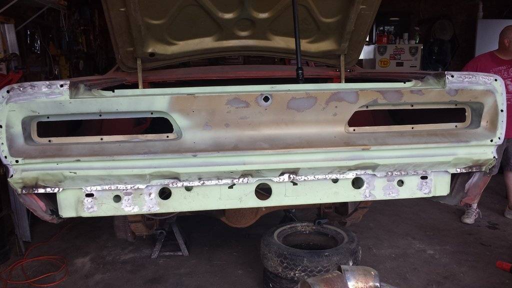

I believe you may be able to use the lower portion after all. At least a fair amount of what you need anyways
